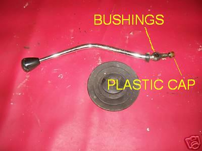

Hunter Posted July 9, 2008 Posted July 9, 2008 I can remember reading a post years ago on ozdat.com. I have been trying to find it with no luck. In that post it explained how to replace the bushes that are on the pin and at the bottom of the stick, with a copper bushes and washers. I actually went to my local Nissan dealer (7) years back and ordered a new set of white plastic OEM bushes. They did not cost me much and my gearbox felt like new. These parts can be replaced with the gear box still in the car. Just think with over 30 years of use these plastic parts have not been replaced. Just some food for thought Here is an ebay listing for the brass bushing. (US $9.99) http://cgi.ebay.com/ebaymotors/DATSUN-NISSAN-BRASS-SHIFTER-BUSHINGS-240Z-260Z-280Z-E_W0QQcmdZViewItemQQcategoryZ33736QQihZ001QQitemZ110268012565QQrdZ1QQsspagenameZWDVW Here is one for the plastic bushing (US $7.99) http://cgi.ebay.com/ebaymotors/Datsun-510-610-710-B210-Auto-Trans-Shifter-Bushings-NOS_W0QQcmdZViewItemQQcategoryZ46101QQihZ011QQitemZ320270001270QQrdZ1QQsspagenameZWDVW The picture below shows where the plastic bushes and the end cap are on the gear stick. You may even be able to still order these OEM parts from NISSAN AUSTRALIA. NOTE: picture is a datsun stick just not a zed car stick. Quote
