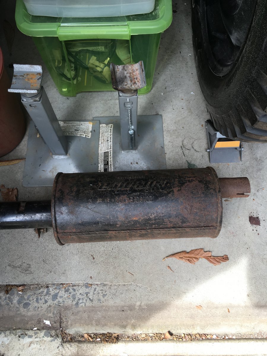

aircobra Posted September 29, 2018 Author Posted September 29, 2018 huge cheers. looks orig, but looks like the tip's been replaced at some stage Quote
aircobra Posted October 2, 2018 Author Posted October 2, 2018 (edited) including some photos i think i worked out the jdm-car-parts mystery https://jdm-car-parts.com/blogs/news/15973536-original-oem-type-muffer-and-down-pipe-finally-launched its actually NOT an exact copy because the standrd off-centre connnector for generic mufflers is not the right size. so they've had to put a kink in the rear pipe to clear the opening the original, had a straight pipe, but the rear hole is somewhere in between the centre and off centre on the generic mufflers therefore the only way to make a copy is to have a custom end plate with z-specific cutout anyway,i've rung around and it seems that people don;t make custom mufflers unless they're stainless big cans and they're welded, not crimped so unless you have a big crimping machine in your garage, not going to happen Edited October 2, 2018 by aircobra gav240z 1 Quote
aircobra Posted October 2, 2018 Author Posted October 2, 2018 had a look inside - its as restrictive as hell - has 3 baffles and very small perforations in the tubes i dont know if anyone still has one of these, but highly likely that stock 240 sounded absolutely granny spec pretty disappointing - i though it would have some special magic inside Quote
