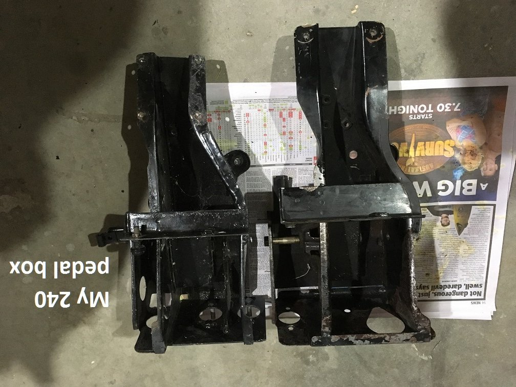

So I was swapping over my pedal box in the 240 and I've struck a problem.
The one in the car had been modified to suit twin cylinders and I wanted to go back to a single master cylinder. I have gone R33 brakes and so wanted the larger mc and booster.
I bought another pedal box and thought it would be a simple swap, but not the case.The steering mount bolts are different. Two bolts instead of four and bolts spaced wider . It also looks longer. I might be able to make it work if I modify the mounts but not sure if it will fit in..
Does someone know what it is and if likely to fit in?

Small one is 240Z (IIRC), and the larger one is 260Z.
The 260Z PB won't fit with serious re-engineering. It also won't easily fit the column or dash.
I suggest you modify the 240Z PB to accept the R33 booster/master assembly, as it will be easier than converting the 260Z PB.

Thanks. Yes it would need some work.
I might have a hunt first for another standard 240 pb before modifying it. That way if I don't like the booster setup I have the option to put the twins back on.
