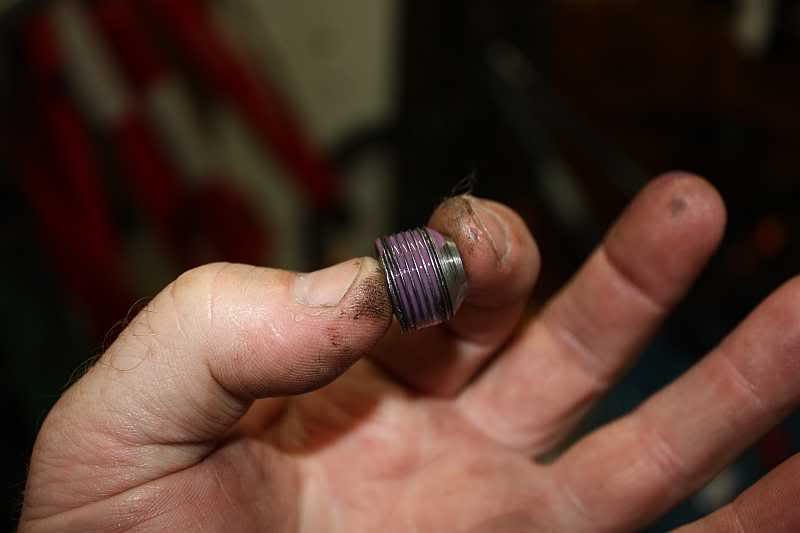

1600dave Posted April 20, 2018 Posted April 20, 2018 (edited) Loctite thread sealant did the trick for me, can't remember exactly what one I use, but its purple ! You haven't tapped for BSPT thread and used NPT plugs (or vice versa) ? Very similar threads but not quite the same. Edited April 20, 2018 by 1600dave Quote
Riceburner Posted April 20, 2018 Author Posted April 20, 2018 (edited) Used the permanent one, it’s the only one I use. Hehe. Is the purple one gasket maker or something? Good question re thread pitch, I didn’t purchase them. Will check. Edited April 20, 2018 by Riceburner Quote
1600dave Posted April 20, 2018 Posted April 20, 2018 (edited) As well as some sizes having very slightly different thread pitch (although some sizes have same pitch, which is confusing...), another difference is thread "angle" - one has a steeper angle than the other so although it screws in OK, the thread on the plug is "narrower" than the thread in the hole it goes into, allowing oil to run back down the "gap" and leak. I can't remember exactly which is which, but that's the general idea. Don't have the purple Loctite anymore and can't remember what type it was (it ended up leaking through my toolbox and getting tossed out), but it was the recommended type for sealing tapered plugs when I did my engine Edited April 20, 2018 by 1600dave Quote
Riceburner Posted April 21, 2018 Author Posted April 21, 2018 Looks like he bought a M12x1.75 tap and a grub screw to suit. Don’t think it was tapered, Doh! Quote
dat2kman Posted April 22, 2018 Posted April 22, 2018 That will not be tapered. May need to go up next nearest NPT tap size, and re-tap, and fit corresponding plug. Quote
