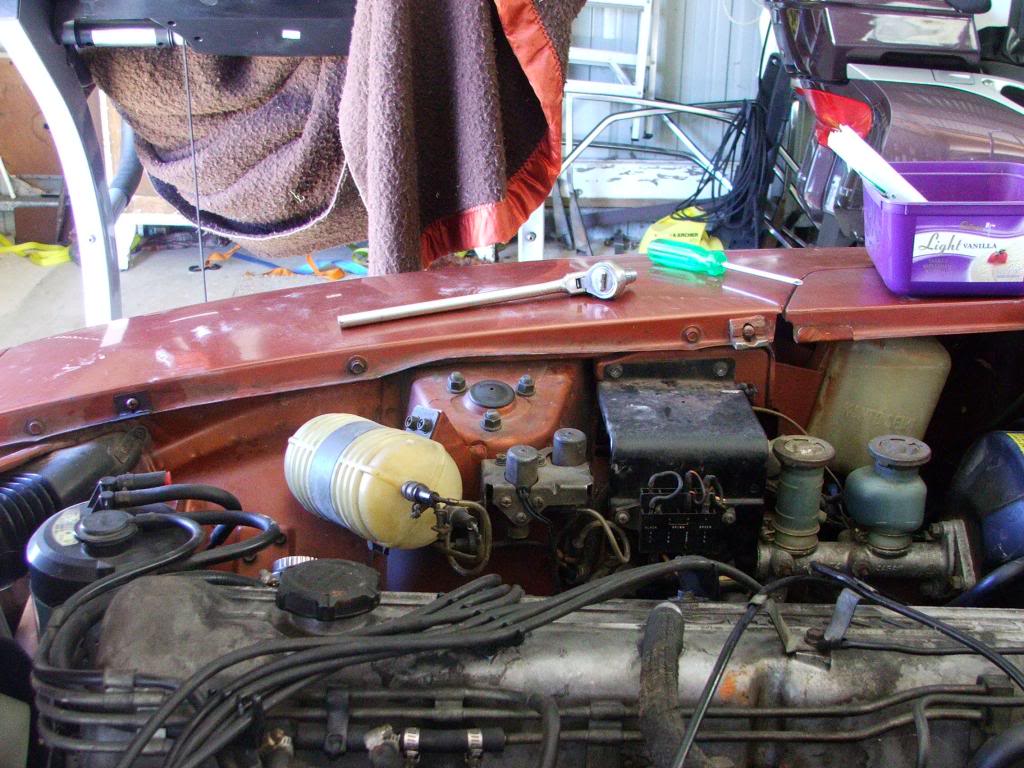

Linton Posted December 28, 2016 Posted December 28, 2016 (edited) ok apologies to all, specially Bobby, relying on an old brain instead of having a look. Bobby I cant find the actual amps it was years ago I changed from fusible links, 30 40 and 80 are most likely correct. how ever I am using 40 60 and 80. Now that I have looked at how I changed the wires I need to redo it and use correct size wire into the the fuses, so thanks for the push to go and have a look. There was no cover that I said it had, I now also realise that, so foot in mouth syndrome again. the fuse block is VN holden from the local wrecker. Edited December 28, 2016 by Linton Quote

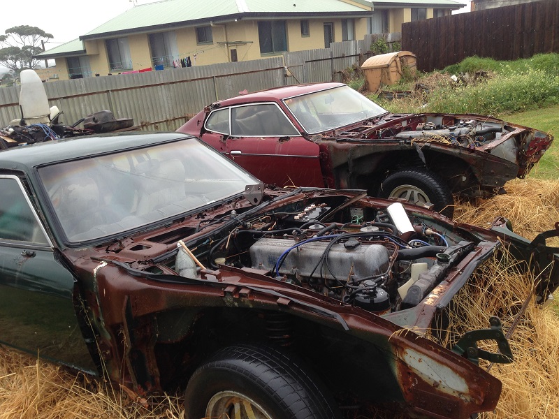

GongZ Posted December 28, 2016 Posted December 28, 2016 Hi Linton, Assuming that those photos are the 'before' and 'after' pics of your car - I think the previous owner must have already modified the set up. That doesn't look like the original fusible links for a 260Z to me. They usually look like this; These are pictures of Lynton's (with a 'y') car from this topic; http://www.viczcar.com/forum/topic/8252-early-vs-late-260z-fusible-links/ Quote
Linton Posted December 28, 2016 Posted December 28, 2016 (edited) yes they are before and after, I have 2 cars available for reference, the green car unknown year is the same as mine. Mine is 2/76 different doors etc. the red one is 11/76 this car has the same fuse set up that you have, the poor quality photo in my previous post is from the green car. Second photo in this post is mine originally as you can see they are the same ,,more confusion LOL Edited December 28, 2016 by Linton Quote
