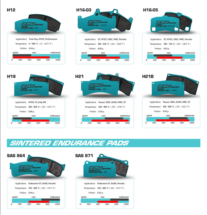

The PMU dealer i talked to said they are a very similar compound to the absolutely fabulous H16-03 which I have used. The main difference is the amount of laps the RC-09 can take the punishment for. If you are doing 10 lap sprints they should be good.
Posted (edited)
The Mu's were sent back, there was a lot of metal in the compound which rightly or wrongly I considered would score the rotors. Those H16-03's have a relatively high friction rate, if they have good modulation then good for sprints?
Edited by 260DET
The H16 compound is faultless. Phenomenal stopping power from first application of the brake pedal on brand new rotors and still fantastic after 23+ hours of non stop track abuse.
