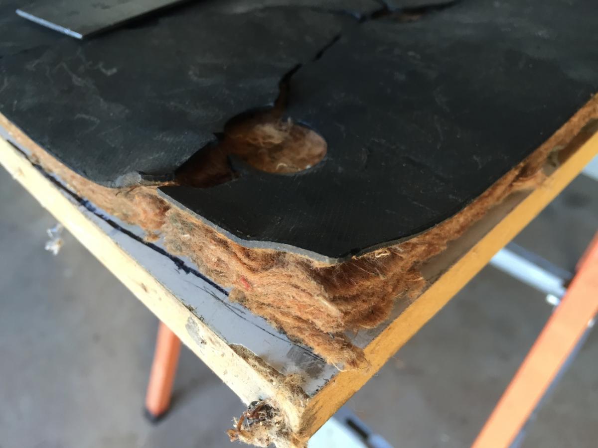

PeterH Posted April 3, 2016 Posted April 3, 2016 Hi Aircobra The firewall insulation is in three pieces...even has the cut outs for the air conditioner hoses.... it's out of a 9th month 1973 car. I'll draw it full size on CAD and print off a template...I'll let you know when I've done it. Pete George and GongZ 2 Quote

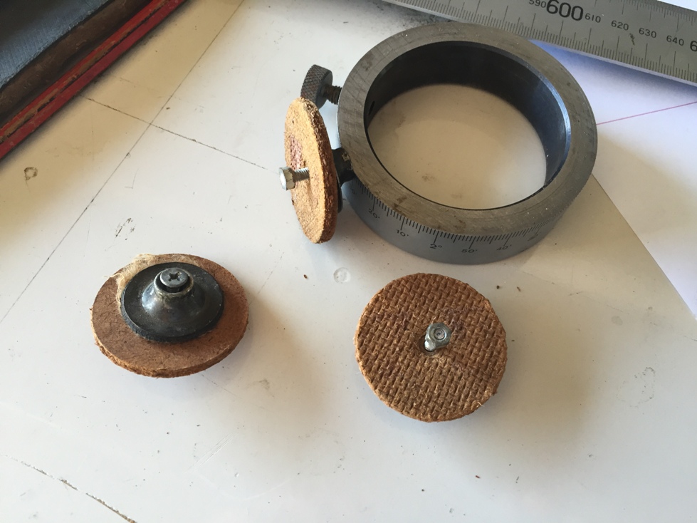

aircobra Posted April 3, 2016 Author Posted April 3, 2016 total champ, what material is it? some people say - black painted cardboard, other rubber definitely has some sort of wadding/jute/heavy foam on the back are there some sort of clips at the bottom to secure the carpet? Quote
PeterH Posted April 3, 2016 Posted April 3, 2016 The clips as shown.... the backing material is good old fashioned "gorilla hair" , faced with a heavy rubber like material . The facing is 2mm thick and the backing about 10mm. Quote
