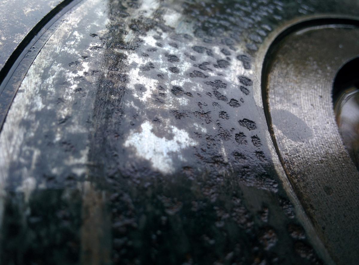

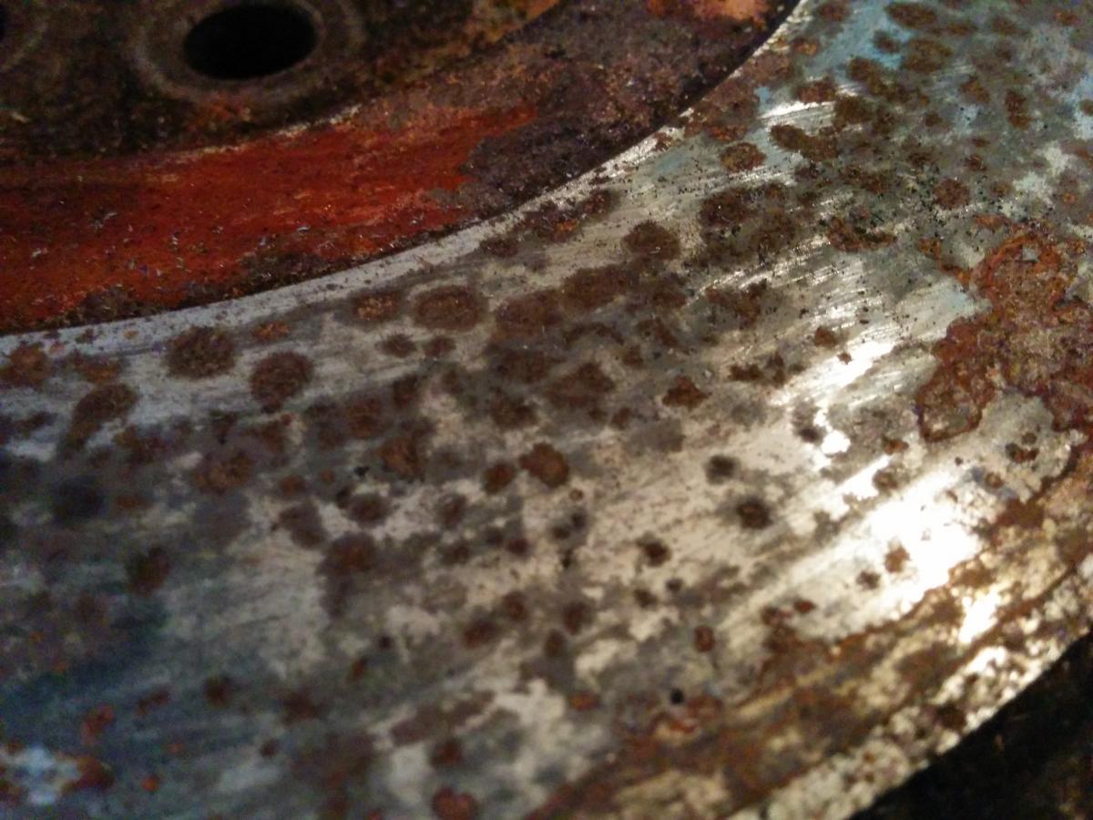

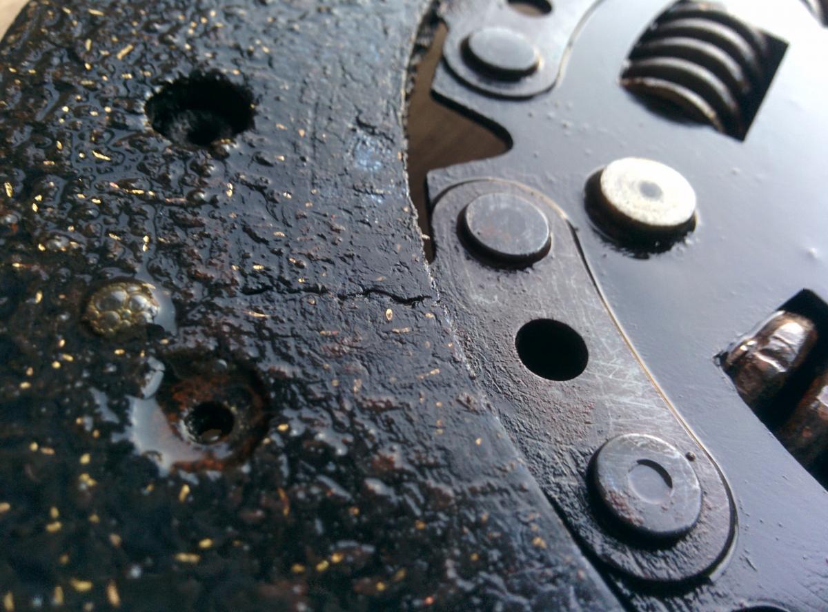

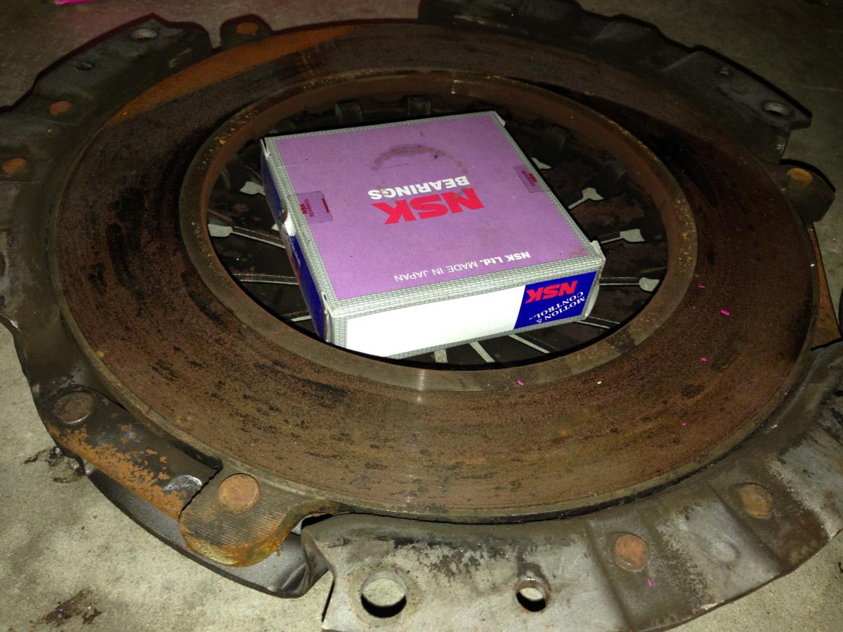

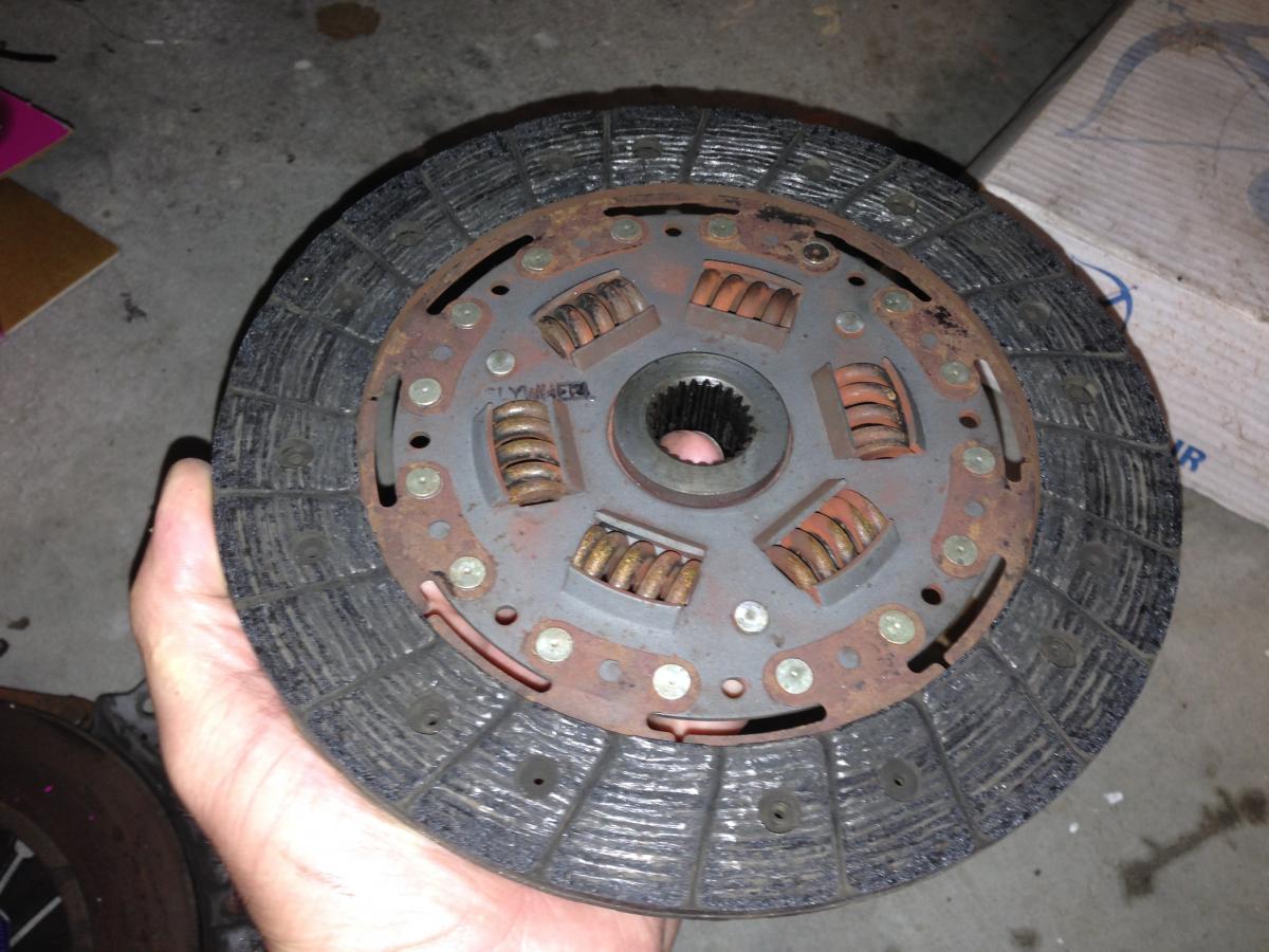

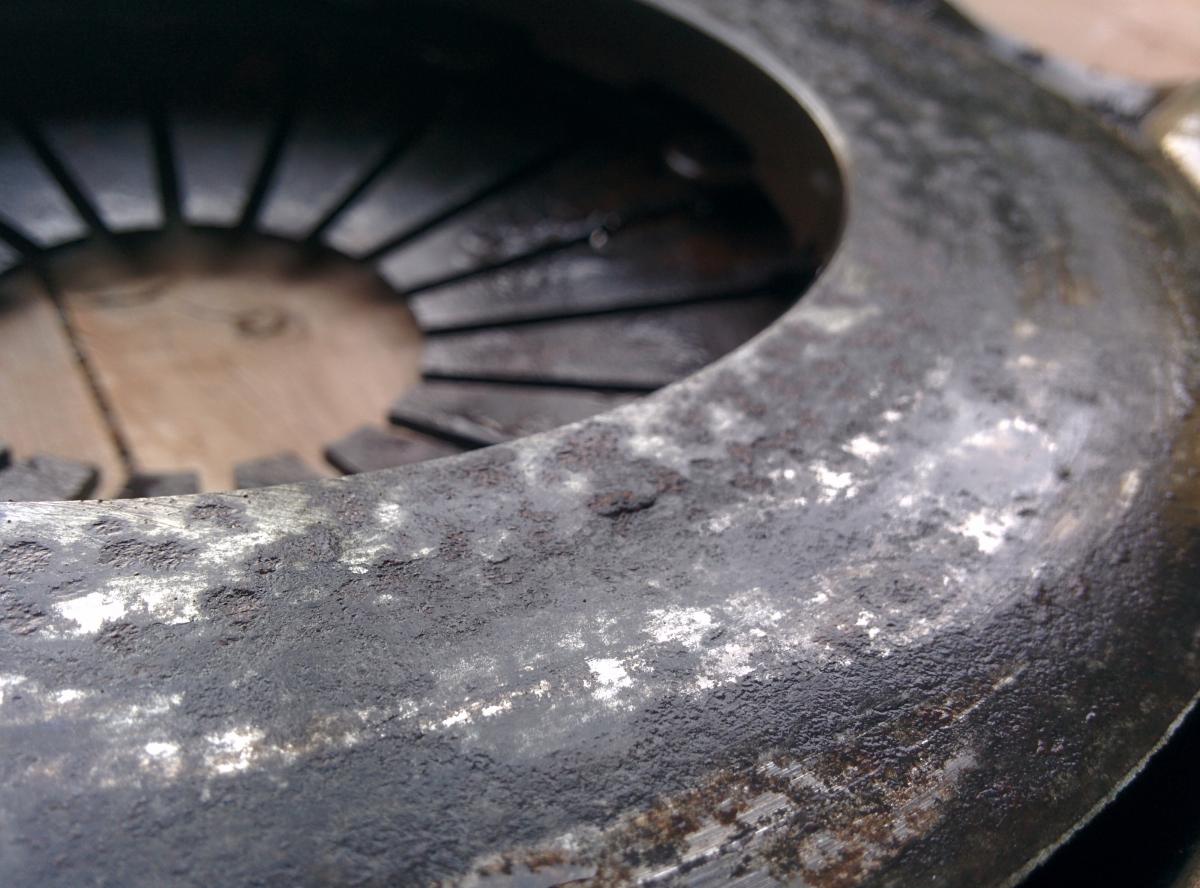

Hi all, Just purchased a flywheel, clutch, pressure plate and a few other parts and I was wondering if they are in usable condition. I'm not expecting much out of them but if I could get 5,000km's out of the clutch I'd be happy. The flywheel and everything is pictured below, the clutch has a small crack in it which is what I'm most worried about (thinking it could shatter etc.) I'm not worried about the life of it all as long as it's capable of getting me to places to get other things fixed (temp rego stuff) until I can sort it out properly or the clutch wears out totally.

Flywheel surface
Pressure plate (could be sanded and cleaned a bit more)
Clutch crack

I wouldn't use them in that condition.
I recommend you get the flywheel machined and use another clutch plate and pressure plate.
Personally I'd get a brand new clutch kit but I'm guessing cash is a bit thin so, get something second hand in better condition that what you've got.

Yep Andrew, there is no way I'd use the current clutch set up you have as it is. The corrosion in the flywheel is something to behold! Never seen pitting like that in 1 before, I guess it was left in the weather for a while?

Yeah, I haven't either. The guy at my clutch and brake shop was pretty impressed too haha, at least I know it's definantly a Datsun part ;)
