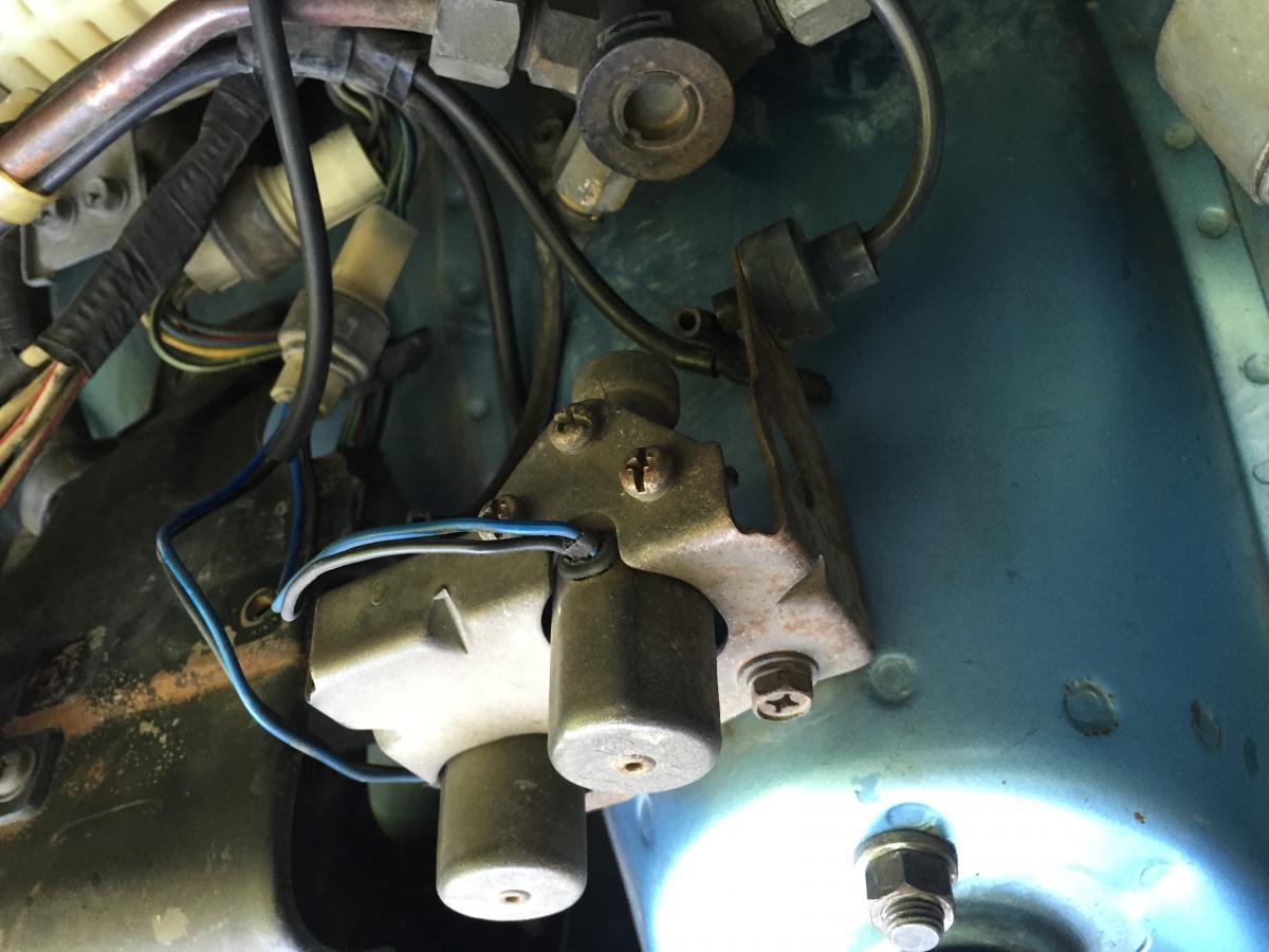

Now the car is on the road I want to sort out a few little things, one of them is the cabin ventilation.

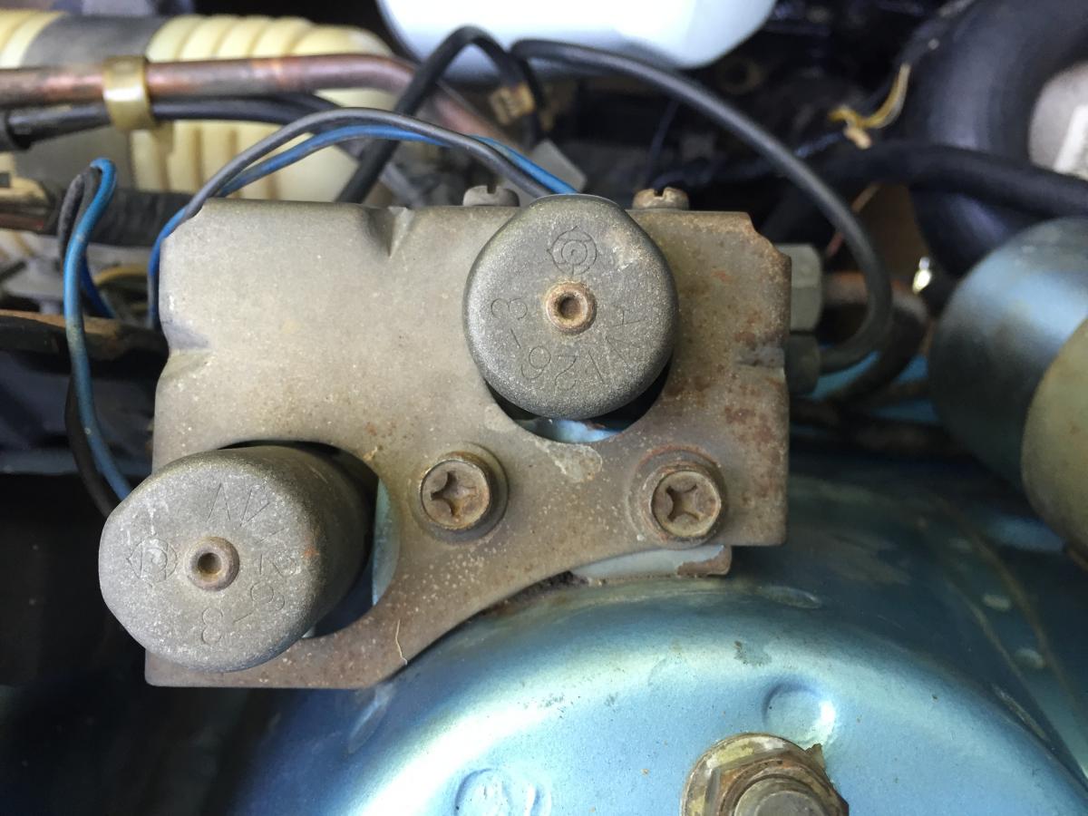

Being a 1977 it has vacuum operated controls. The problem I have is all the vacuum lines lead to these little solenoids and they are broken
Does anybody have a couple of these spare.

I did some research and fiddling yesterday and they are only required for the A/C operation.
I got the ventilation working by connecting the single line that comes through the firewall direct to the inlet manifold.
Currently the A/C is not connected and connecting it is not on the top of the list
