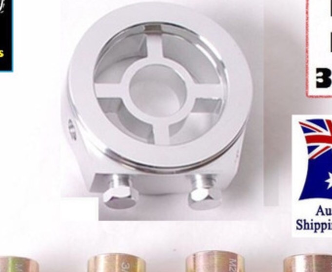

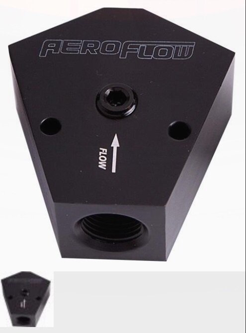

Riceburner Posted October 7, 2015 Posted October 7, 2015 (edited) I'm adding some 52mm Kameari gauges for the new engine, I have oil temp and oil pressure that need to be fitted. Water temp is sorted with a new thermostat housing. I'm thinking of two different options... 1) Fit new oil temp in sump drain plug position, would need to be removed for oil changes. Add a billet 'Y' piece to the block and fit new pressure sensor with the factory pressure sensor in the OEM position. 2) Fit a sandwhich plate, use the two holes for the new temp/pressure gauges. What does everyone recommend? Will the sandwhich plate still allow normal oil flow if both outlets are blocked? Edited October 7, 2015 by Gareth. J. Quote
Riceburner Posted October 7, 2015 Author Posted October 7, 2015 I found this sandwich plate for $34, it says it's specifically for fitting addition oil gauges. The guts of it look fully open, so to me it seems like it should be ok for the job and have no restrictions. Is this a safe way to do it? http://www.neon-technologies.com.au/products/silver-oil-sandwich-plate-for-installing-oil-gauge-sensors-universal-fit Quote

Riceburner Posted October 8, 2015 Author Posted October 8, 2015 Ok, so flow temps going into the motor are the best point to measure. Looks like I'll go with that sandwich plate to start off with then. Not sure if I'll need an oil cooler yet, will depend on what the gauges say. Quote

Riceburner Posted October 9, 2015 Author Posted October 9, 2015 I have a spare 280 sump that's has an extra port in the sump with a temp sensor in it, so I guess it makes sense if the factory did it that way too. It's a 9.5ltr baffled sump, so it will be interesting to see how it all goes. I'll get the cheapo sandwich plate for the extra pressure sensor and then try the temp sensor in the sump plug as it seems to be the same size. Thanks gents Quote
