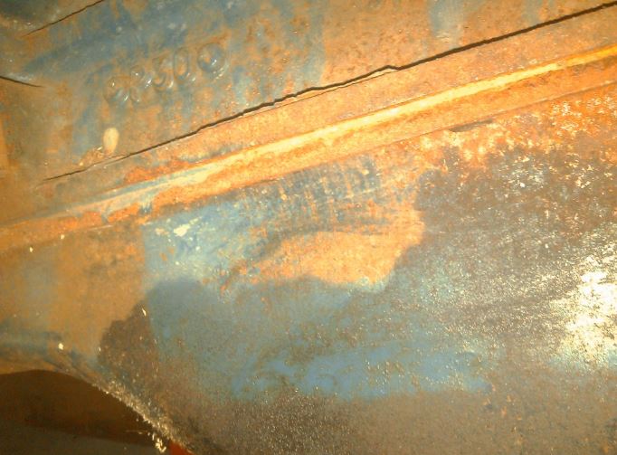

Hi Peter,
I just took a trip to the garage to look at my original motor for you.
The motor, from my 9/73, was pulled out after it had only done about 34,500 miles
and has never been touched before or after.
The photo attached confirms that the sump is engine colour (+ surface rust highlights :P ).
