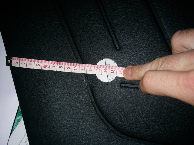

1. The lock position. Early style appear to be 15 cm from the rear of door card.

* The supplier has informed me that the door lock position could probably be moved from 25 cm to 15 cm and you wouldn't be able to notice. So this may be a workaround to our problem with only being able to obtain later door trims. However if the arm rest positions are also different that's not going to go well....

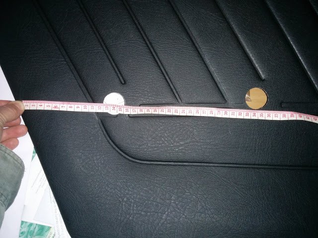

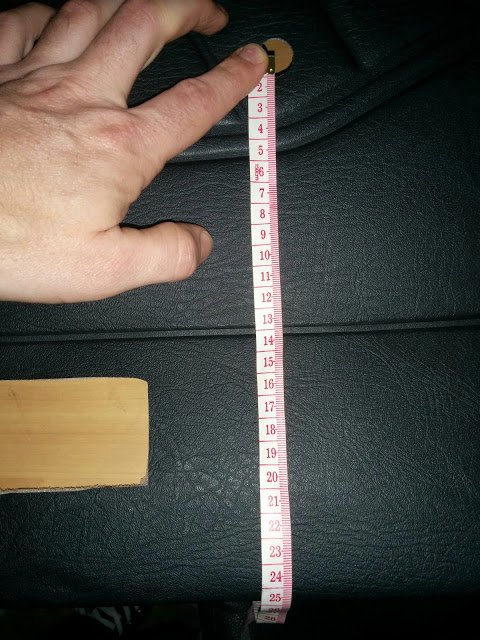

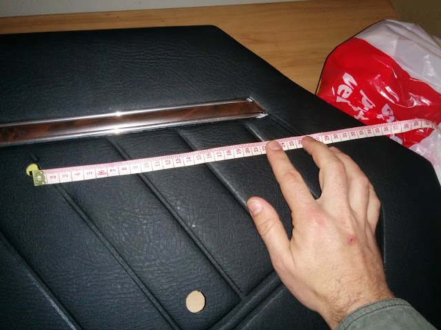

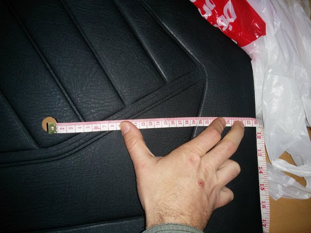

Ok so here is some reference measurements and photos. Not an exact science since there are various curved edges which makes an absolute *fixed* point of reference difficult but you hopefully get the idea and can compare with what you already have.
Rear most (relative to door) arm rest hole. (14 cm from rear of card to center of hole).
Rear most arm rest hole to bottom of door card (20.5 cm)
As you can see the first and second hole are not on the same fixed y-axis in terms of position, the second hole is slightly higher than the first.
The second hole is about (34.5 cm) from rear of door card.
Bottom of door card to center of second hole is (21.5 cm)

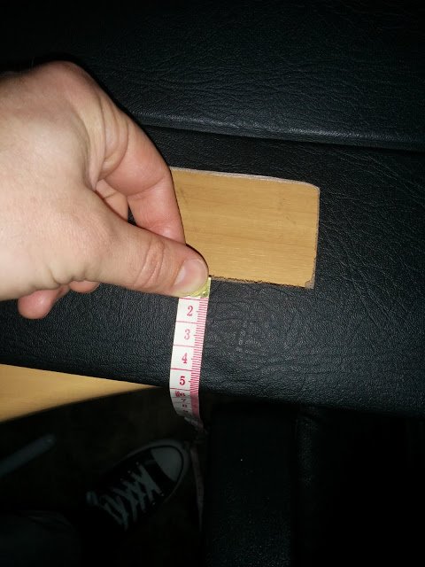

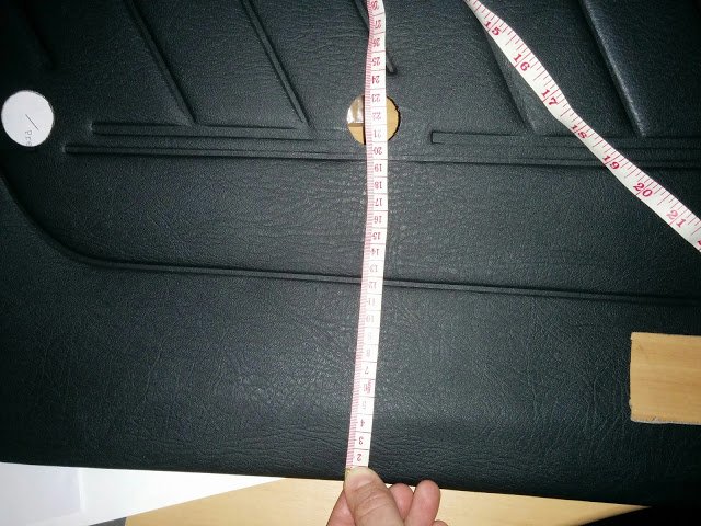

Inner Door handle (square area) is (5 cm from bottom of door trim).
and (34.5cm to front of door trim).
Window Crank hole. (~ 25cm from center of hole to bottom of door trim)
Approx (~ 28cm to front of door trim) window crank hole.

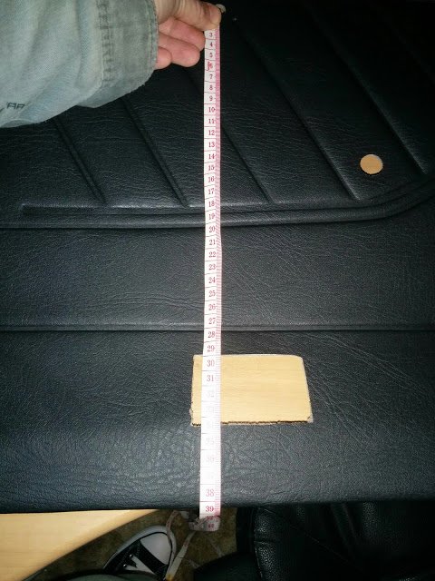

Arm rest upper hole / fixture point. (~38.5 cm from bottom of door trim)
and (13.5 cm from top of door trim)
and (34.5 cm to front of door trim)
and the door lock hole. (~ 22.5cm from rear of door trim)

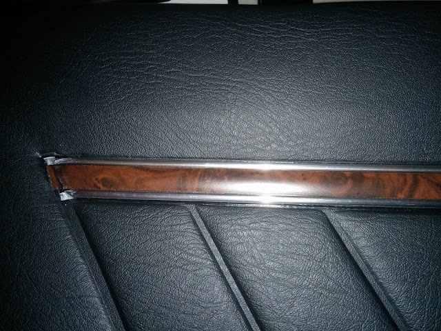

A couple of people asked about the chrome. These photos didn't turn out as well as I had hoped...
There is no flaking on either door trim, if I was to be really really picky on 1 side there is very minor ripple which I don't think anything could be done about in all honesty and it's only in a small part of the strip, not something you would notice unless really looking very close. But the chrome is not peeling or flaking anywhere at all. It's as good as you'll get.
Hopefully this gives you a good reference for your own door trims to compare against. I suspect the main difference on AU delivered '260z's' is the lock position only.

Here is the 260z 2 seater door trim lock position for comparison.

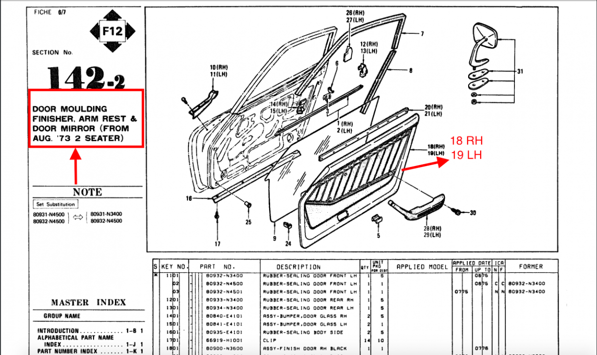

  • 3 months later...

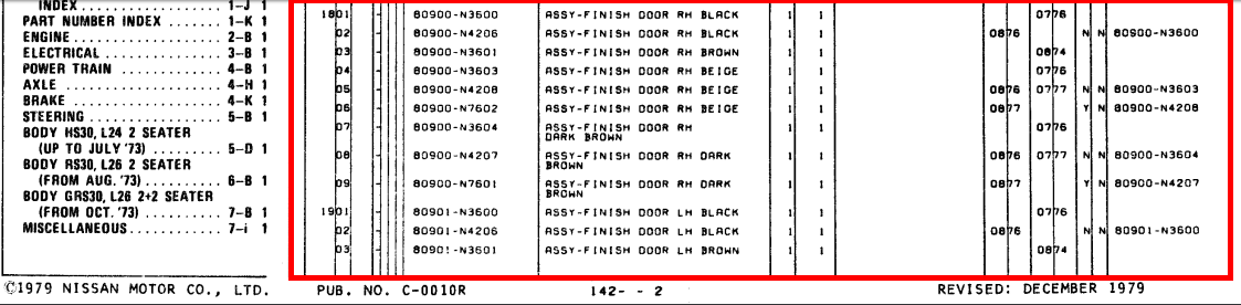

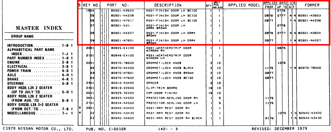

I did some more research into this and found that early 260z door trims use these part no.s
80900-N3600 (Black) Right Hand Side. (up to 07/76)
80900-N3601 (Brown) Right Hand Side. (up to 08/74)
80900-N3603 (Beige) Right Hand Side. (up to 07/76)
80900-N3604 (Dark Brown) Right Hand Side (up to 07/76)
80901-N3600 (Black) Left Hand Side. (up to 07/76)
80901-N3601 (Brown) Left Hand Side. (up to 08/74)
80901-N3603 (Beige) Left Hand Side. (up to 07/76)
80901-N3604 (Dark Brown) Left Hand Side (up to 07/76)
It looks like brown was only available for 1 year (1974).

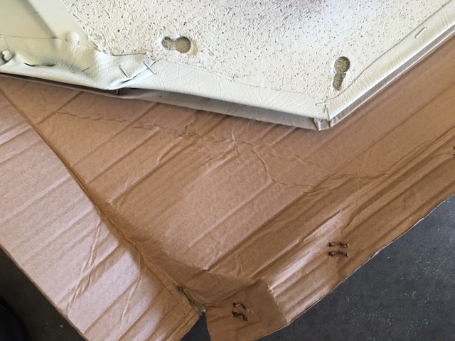

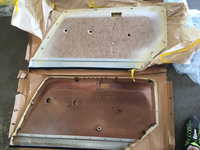

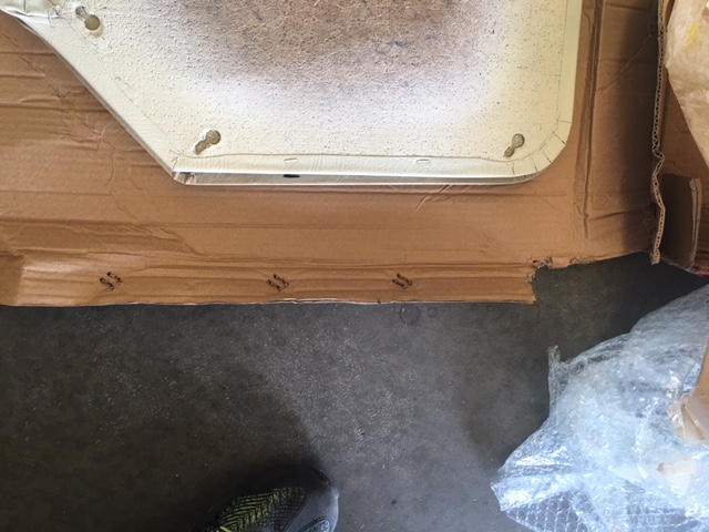

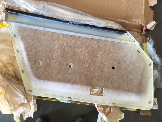

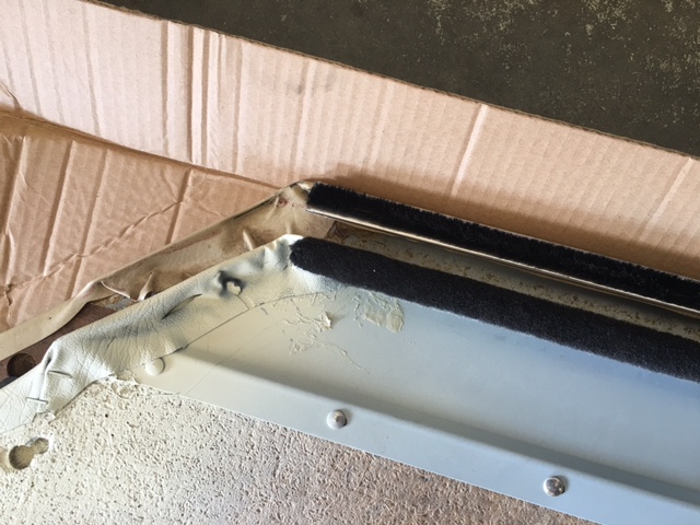

So the reproduction trims for 74/75 model 260z's ended up not being such a great fit. I believe this is because they were really just later style trims that were modified with an assumption that the only difference between early and late was the lock position. However as I found out the earlier trims also have slightly different locating pin positions on the rear of the trim to the later ones. I don't believe that there is any issue fitting the reproduction trims to later 260z's.
I've attached some photos that compare the original OEM door trim with the reproduction trim.
You can see the door trim is a bit smaller on the leading edge than the original.
another angle.

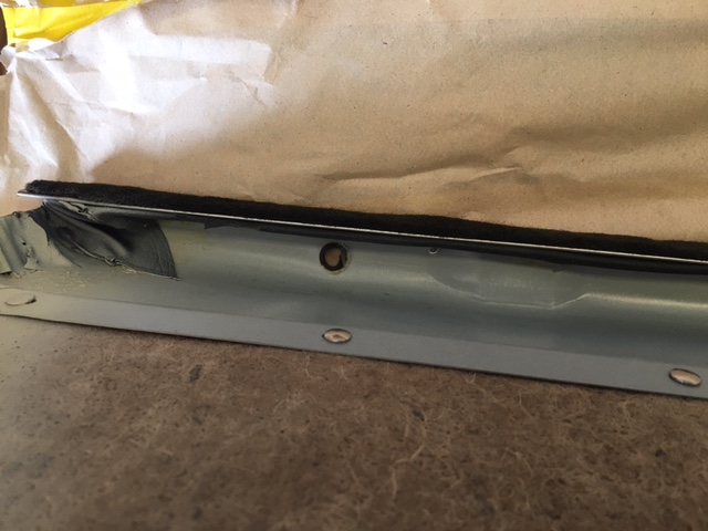

I believe the door handle position is also slightly different between early and later cars. Which is another reason that simply drilling a hole 15 cm from the rear of the door card won't allow these trims to fit an earlier 260z.

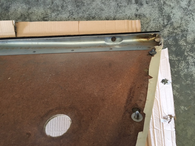

You can see the depression in the upper door trim bracket where the hole was designed to be for this door trim. So we can only assume the reproduction items were based on a later 260z style template.
On the OEM trims you can see the depression is exactly where the hole is for the door lock pin.
In this photo compare the position of the locating pins on the rear of the door trim. You'll see they are quite different between the 2. Again another reason why I feel these were designed for later cars only and modified to suit earlier cars without realising there was additional differences.
In this particular case since the doors were re-dyed from black to white (before test fitting) we couldn't return them to the supplier. In the end I helped the owner source OEM door trims which cost more, but for the quality of the build it was necessary to go OEM. The reproductions could have been made to work with some modifications etc.. and may have been ok on a less than perfect rebuild, but the build I supplied the OEM parts for was a concourse restoration of a 260z hence it needed to be spot on.
