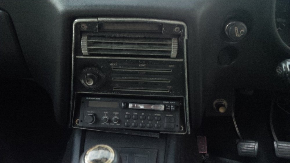

sorry i had to start a new tread. Does 1972 240z originally comes with hazard light switch? I cant seems to find mine  :-\
There is a empty button below the ciggy switch,

Australian 240Z's did not have hazard lights fitted (and maybe the UK cars, or even all exported RHD 240Zs, were the same).
Your guess is correct, the unused switch position shown in your photo is where the switch should be added.

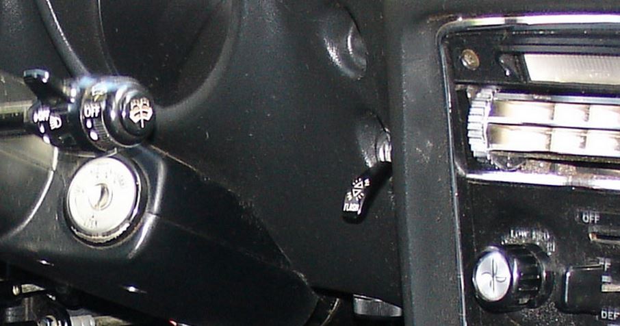

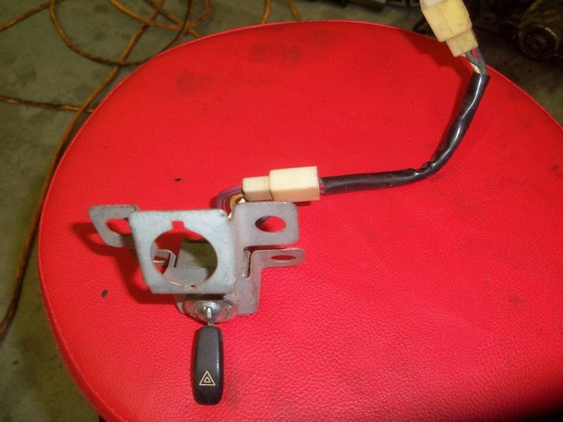

The photo below shows an early US 240Z hazard switch. There were two early rocker switch types and a later push/pull type, as shown on the first page of the topic I have mentioned above.

Its this okie? Seems like it has less wires then the picture you posted in the other tread.
Yes that should be fine. You just need the 6-pin connector your car.
Because the US cars had a different tail light set up, they had the brake light circuits going through the hazard switch, which is why they had an extra connector.
