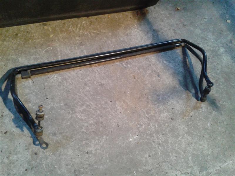

The picture below is of a 260Z 2 Seater item with a 2+2 rear bar on top of it. As you can see they are the same. I believe them to be the same as a 240Z. I can compare it to a friends but i'm sure i have been down this path before. I even have the hinge bushes but i don't have spare brackets. I do however have the ones off my 2 Seater which i can make a template of. Let me know if this suits your needs.
The 240z bar is different, going by the rear in in the 240 I have here, and comparing to the 260 2seater.
The "hinge" mounts a located onto floorpan in different positions.
HTH!

I just tried fitting "a260z" 2 seater bar into a early 240z, no go, no-where near it.
