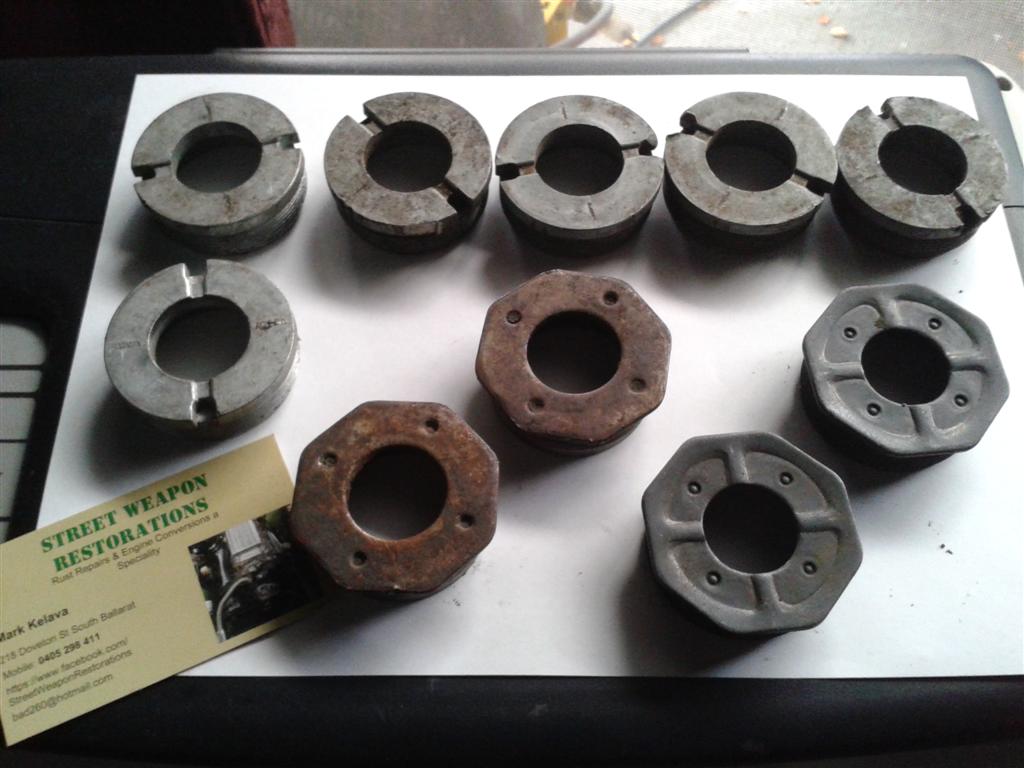

dat2kman Posted May 18, 2015 Posted May 18, 2015 As most of you know, I am happy to help out where I can, and if it involves a few beers, or a bottle of 'Ard 'Licker, even better! Ok, Casey T ( short curly headed passionate about his very neat 240Z Kiwi feller, AKA Z, on here) Has asked me to give him a hand, in fitting up lots of shiny polished bits, mainly from AZC, who has been most helpfull, to his 240Z This involves fitting the 260 Z struts he bought off a fellow member! Here's the problem, Casey took his 260 Z F&R complete struts to Ken Graham at Accurate Suspension, here in Qld, and asked Ken to strip them down, remove hibs and LCA'a etc, so Casey could get them powdercoated to look nice. Ken told Casey the fitted Bilstein inserts were rooted, and decided to keep them, along with the 260Z strut gland nuts! Now, Ken Graham tells young naive Casey his Bilstein inserts are " gone" and has no knowledge of the gland nuts. Casey did not realise the Billies are rebuildable and are as expensive as they are, and has been told by Ken to cut off the already sectioned struts and weld on Commodore threaded top section and se Commodore nuts. Nice bloke hey!!! We think the Billies are long gone, into someone elses Z, and now ASAP, to get Casey's car finished, we need four x Strut Top tube Gland Nuts to suit the bigger 55mm 260 Z struts. Can someone post them to me. Casey will be sure to fix you up with $$$, i wont let his car leave my shed until he does! Quote

dat2kman Posted May 18, 2015 Author Posted May 18, 2015 240z is about 46 mm diam, 260 Z is about 51.5mm diam on the gland nut. Quote

Scoota G Posted May 18, 2015 Posted May 18, 2015 I should bet able to assist with this. I have one set for sure. PM me buddy. Quote

Scoota G Posted May 19, 2015 Posted May 19, 2015 Best send me a text and let me know which ones. These are all 260Z. Quote
dat2kman Posted May 20, 2015 Author Posted May 20, 2015 Seeing as the suspension shop here in Brisbane, decided to not return them,,,,, We dont know which ones! The ID of the thread on the struts is about 51 mm, and the Konis we are fitting stand up out a little, so the "deepest" or tallest ones of those that can accept the top of the insert poking out a little. ( i can easy enough fit spacer rings if need be) Quote
Scoota G Posted May 20, 2015 Posted May 20, 2015 Tell you what i'll send 4 round ones up and four of the others (two of which are genuine wet leg items) see which ones float your boat. Quote
dat2kman Posted May 20, 2015 Author Posted May 20, 2015 Tell you what i'll send 4 round ones up and four of the others (two of which are genuine wet leg items) see which ones float your boat. Thanks Mark! Quote
Scoota G Posted May 21, 2015 Posted May 21, 2015 I just sent them Express post so you should have them for this weekend. Quote
