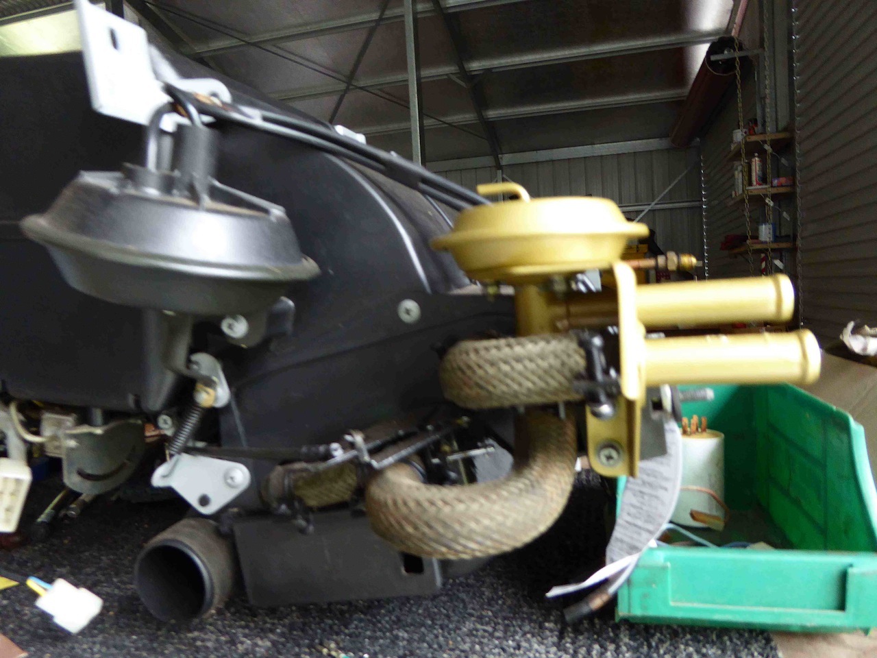

YosemiteZed Posted March 22, 2015 Posted March 22, 2015 Hi Guys Trying to finish off my heater/ac for my 260 and I have a completely rusted out vacuum actuator for the water heater cock If any people can help me with a replacement it would be greatly appreciated or an successful alternative The part that I am after is the gold thingy in the image attachment send me a pm if anybody can help so we can come to an arrangement cheers Phil Quote
Scoota G Posted March 22, 2015 Posted March 22, 2015 You might have to return this part to cable operation. It's only for the hot/ cold function anyway. Failing that take your old one and see if a local wreckers will have something similar. They are very simple in operation. Quote
Retro Z Posted March 22, 2015 Posted March 22, 2015 http://pages.ebay.com/link/?nav=item.view&id=261782106001&alt=web Quote
Scoota G Posted March 23, 2015 Posted March 23, 2015 http://pages.ebay.com/link/?nav=item.view&id=261782106001&alt=web He's chasing the actuator buddy. Quote
gilltech Posted March 23, 2015 Posted March 23, 2015 Ditto ScooterG, just make it cable operation, not all 260s had the actuator, mine doesn't. Quote
