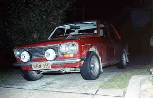

HKSZ Posted January 13, 2015 Posted January 13, 2015 Would these pass a scrutiny check if I wanted to go hillclimbing? 7'' globes with 235/60/14 Yokies 352 looks like they stick out a bit, nothing ridiculous but the lenghtened arms on the rally car don't help. Just a one off thing won't be changing the rally set up. Quote
dat2kman Posted January 13, 2015 Posted January 13, 2015 A235 tread width tyre on a 7" wide rim, will have the tyre wanting to fold over, unless you run very high PSI. High PSI will not allow the tyre on that rim to work to optimum. F these are what you jave, they'll be ok, but look at 38-42 psi. The main thing is, get out there and just give it a go, you'll have plenty fun, and get to see, and talk to, others and ask them how they set their car up! Deally, a 205/55 or a 205/60 on the 7" rims allow you to drop pressures to around 24-26, which allows flex in sidewall, and keeps as much tread surface flat on the road surface, though the suspension travel. Quote
HKSZ Posted January 14, 2015 Author Posted January 14, 2015 Yeah they are big boots i guess I'll have to give it a squirt on the local hills. Your right on the side walls, when fitting them to the rims I noticed alot flex for what was an expensive tyre Quote
