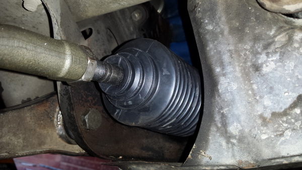

cracker Posted December 28, 2014 Posted December 28, 2014 Just got quoted $88 per side by Nissan for JUST THE BOOT - and the part is still ex-Japan so I'll be waiting a while. Does anyone know if these can be sourced locally as an aftermarket or universal type boot? I know I can source an aftermarket part from msa so will do that if nothing easier is found - I need to re-assemble the steering before Wednesday so ideally can get my hands on one in the next couple of days. Thanks James Quote
Moderators PB260Z Posted December 29, 2014 Moderators Posted December 29, 2014 Gidday Good chance that Repco or equivilant parts supplier will have something the right size. Take a sample, or at least the key measurements. Should cost way less than OEM. Worst case evilbay for about $25 Cheers PB Quote
Moderators PB260Z Posted December 29, 2014 Moderators Posted December 29, 2014 Hi Was a bit bored so hit Google up, Burson's do a generic kit that could be worth looking at http://www.burson.com.au/cv-steering-rack-boots-c-103_116_287.html?osCsid=614175f3d80a3b1722004255bb72bdf8 Quote
cracker Posted December 29, 2014 Author Posted December 29, 2014 Thanks PB, I actually couldn't find anything on ebay - maybe I've searched poorly? Got a link? Bursons don't have anything on their system that matches up for 240z but I will pay them and Repco a visit this afternoon and see if I can't find something that will do the trick. Will report back. Quote
Moderators PB260Z Posted December 29, 2014 Moderators Posted December 29, 2014 I actually couldn't find anything on ebay - maybe I've searched poorly? Got a link? Try this ebay link. Searched for "Steering Rack Boot" http://www.ebay.com.au/sch/i.html?_from=R40&_trksid=p2141725.m570.l1313.TR1.TRC0.A0.H0.Xsteering+rack+boot&_nkw=steering+rack+boot&_sacat=0 Quote
cracker Posted December 29, 2014 Author Posted December 29, 2014 Cheers! Bursons have a universal type boot which can be cut down to size at $13ish each. I've bought these which should fit quite well anyway. I'll be installing tomorrow so will post photos of success (or failure I guess haha) then. James Quote
Moderators PB260Z Posted December 29, 2014 Moderators Posted December 29, 2014 Cheers! Bursons have a universal type boot which can be cut down to size at $13ish each. I've bought these which should fit quite well anyway. I'll be installing tomorrow so will post photos of success (or failure I guess haha) then. James Cool, look forward to seeing photo's of your sucess. Cheers PB Quote
Moderators PB260Z Posted January 5, 2015 Moderators Posted January 5, 2015 Perfect fit Great result, and heaps cheaper than the first price of $88 per boot. Glad it worked out. Cheers PB Quote
