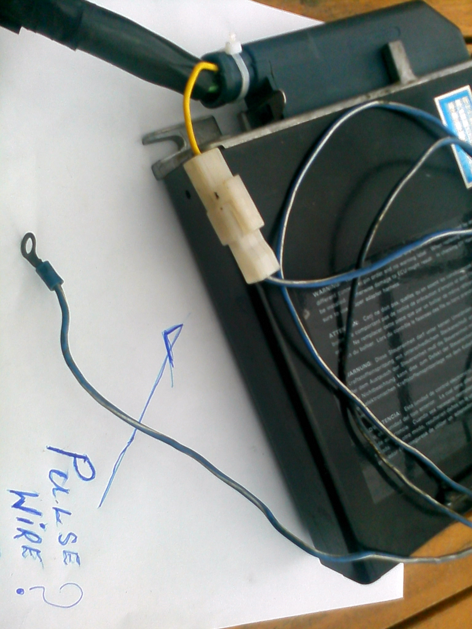

zeds4ever Posted December 10, 2014 Posted December 10, 2014 Finally finished re wiring harness up for series two 280ZX F/I unit. Need to know where to connect pulse wire that is attached to ECU & connects to either + or - on coil methinks .The dissy is electronic & the car is a 260Z. Regards: Alan. Quote
Linton Posted December 10, 2014 Posted December 10, 2014 G'day Alan not sure what you are after, from memory the fuel system doesn't have anything to do with the distributor or the coil, they are wired up as per normal Quote
pauly_adams Posted December 11, 2014 Posted December 11, 2014 yeh the dizzy works of the ignition module on the side of the dizzy and the injectors work off the air flow meter Quote
Linton Posted December 11, 2014 Posted December 11, 2014 just checked mine its black and it goes to the - coil. I ran the wire along the loom and re taped the loom forward to the junction where it splits off to the coil Quote
