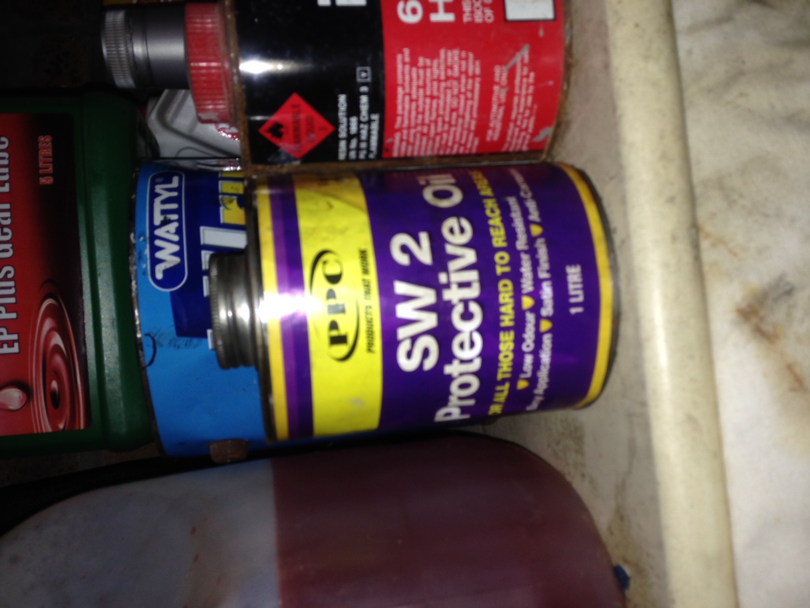

zed74 Posted December 12, 2014 Posted December 12, 2014 SW2 Curing Oil is the best product I have found - can be used elsewhere & painted over too... Quote
240z71 Posted December 13, 2014 Author Posted December 13, 2014 Thanks guys Some good products you guys have mentioned there, might just come down to price/avalability now. How did you guys go about preparing these areas for the products Quote
