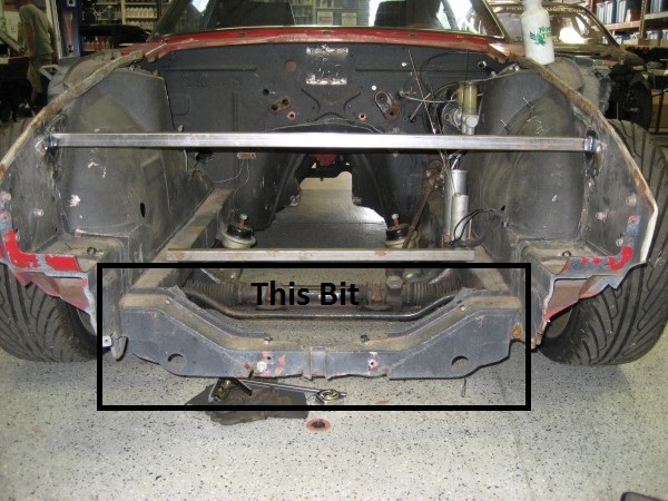

Karljsw Posted April 23, 2014 Posted April 23, 2014 Hi Guys Im in need of a radiator support cross-member with very little rust preferably none as the repair certifier does not like rust! Let me know what you've got Cheers Karl Quote

Karljsw Posted May 12, 2014 Author Posted May 12, 2014 Bumpity, since finding a straight rust free cross member is rather difficult and My Mum is starting to get annoyed at the lack of progress on the datsun. Does or could anyone give me some accurate measurements of the crossmember so i can get one fab'd up over here? I've got a 1m section of 60mm x 60mm x 4mm SBS that I was planning on using to make one up and i have a mate who works as a welder. I know the steel is slightly the wrong dimensions, but as far as im concerned its close enough (near as makes no difference 5mm to wide and 2mm too high) and the original being something close to 2mm thick another 2mm will add more strength. Cheers Karl Quote
Scoota G Posted May 13, 2014 Posted May 13, 2014 Bumpity, since finding a straight rust free cross member is rather difficult and My Mum is starting to get annoyed at the lack of progress on the datsun. Does or could anyone give me some accurate measurements of the crossmember so i can get one fab'd up over here? I've got a 1m section of 60mm x 60mm x 4mm SBS that I was planning on using to make one up and i have a mate who works as a welder. I know the steel is slightly the wrong dimensions, but as far as im concerned its close enough (near as makes no difference 5mm to wide and 2mm too high) and the original being something close to 2mm thick another 2mm will add more strength. Cheers Karl What if i made a template of one out of cardboard and sent you that over? Can't have your mum goin crook! Quote
Administrators gav240z Posted May 13, 2014 Administrators Posted May 13, 2014 You might want to be patient and hold out for Nato to finish his. http://www.viczcar.com/forum/index.php/topic,12469.0.html I see you PM'd him about it, but I'd go new metal over old if possible . Quote
