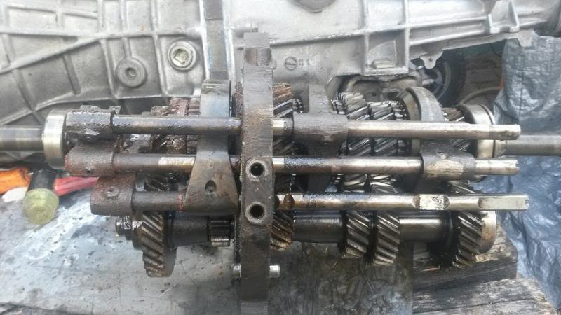

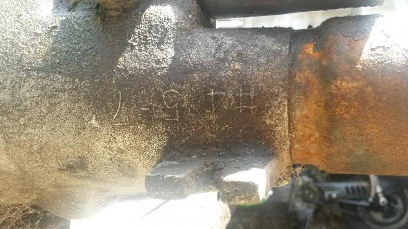

scott Posted March 20, 2014 Author Posted March 20, 2014 240k. I got given this box when i bought a load of parts. No idea what it could be from and if its a 4 speed or 5 speed. Has these markings Only after the front housing for my rb20 box Quote

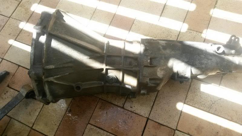

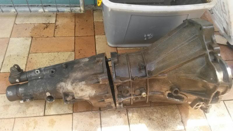

d3c0y Posted March 20, 2014 Posted March 20, 2014 Have you got a picture of the housings for that box, that is generally the easiest way to tell what it is, for me anyway. Looking at the internals it looks like a five speed to me. Quote
d3c0y Posted March 21, 2014 Posted March 21, 2014 Looks like the right bell housing to me. Compare it to mine and others on the internets. Quote
Riceburner Posted March 21, 2014 Posted March 21, 2014 I'm no expert but it looks the same as my old 260z box only better, Supposedly fully rebuilt but looked like it was found at the bottom of the ocean. Dat2kman or PMC are experts on this. To be certain you could swap the front mainshaft & countershaft bearings from the 260 gearset to the RB gearset, enlarge the shift rod holes and see if it slides together (the anti rattle shim will bind on the L series bell housing inner face, kinda looks like a power saw blade) or leave the shim off. If it does get the bearing holes enlarged and the inner face plunge cut to suit RB sizings. Stuart Wilkins motorsport has all the bearings, syncros, seals in stock. I did an RB20det close ratio rebuild a not too long ago, it's so much better than the original boxes! Quote
dat2kman Posted March 21, 2014 Posted March 21, 2014 YES It is the same front bell. Follow the instructions on this site re drilling/machining etc. It bolts on and in. Quote
