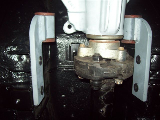

This may sound complicated but here goes.

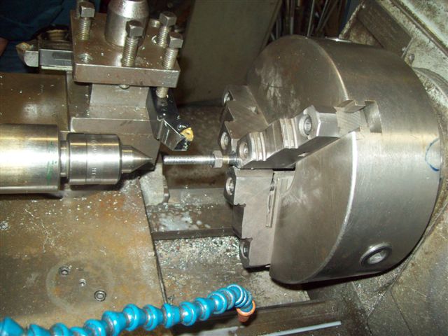

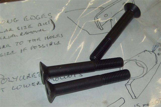

When I fitted the Holden diff I had to use countersunk bolts to ensure clearance of the rubber drive coupling. I found that no bolt supplier had them in fine pitch. I bought longer bolts with a plain shank and by holding the head in a lathe chuck I could cut a fine thread on the previous plain shank. I then cut them to length.
Any small machine shop should do it for a couple of bob.

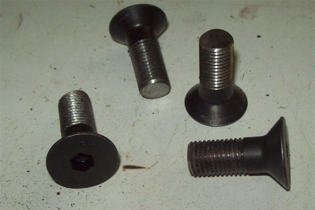

Hi Kirby
I replaced mine with a stainless steel hex head socket c/sunk
316ss  8mm x 20mm  thread pitch 125

Seems urgent is a 2 week thingy on AusZcaR!
