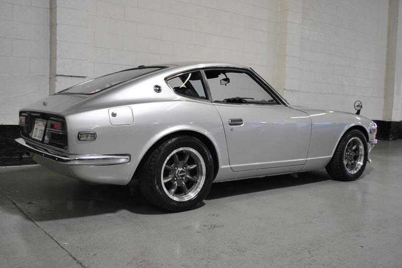

24OUNZ Posted December 5, 2013 Posted December 5, 2013 Hi Guys, Im sorry to be asking a question that has been asked many times before but I've trolled through the threads and found definitive answer. I finally purchased a 240Z yesterday first thing ill be doing is replacing the wheels and tyres and giving her a good cut and polish! ……..So the setup I'm looking at doing is ROTA RB Hyper blacks 15X7s +20 (standard wheel form Rotas website) with 225/50 R15 wheels all round. Im going for a similar look to this silver Z. So will this work on a standard setup 240z no guards flared etc… Thanks Al Quote
