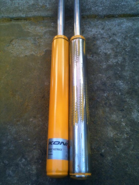

Moderators Zedman240® Posted October 25, 2013 Moderators Posted October 25, 2013 I took to my Koni yellows with some wet and dry paper and took some microns of my shocks to get them to fit... I'm dreading the day I have to remove them.. Quote
adam Posted October 25, 2013 Posted October 25, 2013 This is what I had to do to my brand new Konis They wouldn't slide in due to corrosion otherwise! Quote
