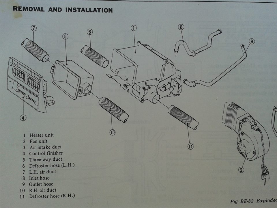

Scoota G Posted August 27, 2013 Posted August 27, 2013 In the 260Z take out the air vent panel and the square-ish shaped heater matrix behind it. You'll need to remove the side brackets that mount the front panel. There are 2 screw at the rear of the matrix on the top both left and right side, you only need to loosen them as the matrix only slides over them which also means that the tabs are easy to break so go slowly. Once you have that out you'll have heaps of access. Get a light and a mirror and start feelin around. Quote
Luni260z Posted August 27, 2013 Author Posted August 27, 2013 Thanks Scoota, you're a champ. No idea what half these terms mean, but i'm sure once I get in there I'll be able to spot the heater matrix. Thanks for the quick reply. Quote
Scoota G Posted August 27, 2013 Posted August 27, 2013 The heater matrix is just a rectangular shaped box behind the middle vents, despite it's complex name it's very simple. Quote
Luni260z Posted August 27, 2013 Author Posted August 27, 2013 Finally got some action. Wasn't sure how to get the bulbs out, ended up taking out one of the dials and realised you just yanked em out. There weren't as many globes as I was expecting, was told by zstore that there was one for the clock, two for the amp/fuel, two for oil/water. Unless I'm missing something, they all only appear to have one glove each. Now have to try to access the ones behind the speedo and tacho and starting to lose light. Oh well, wish me luck. Thanks for that diagram Scoota, might be helpful when I come to putting it all back again. Quote
