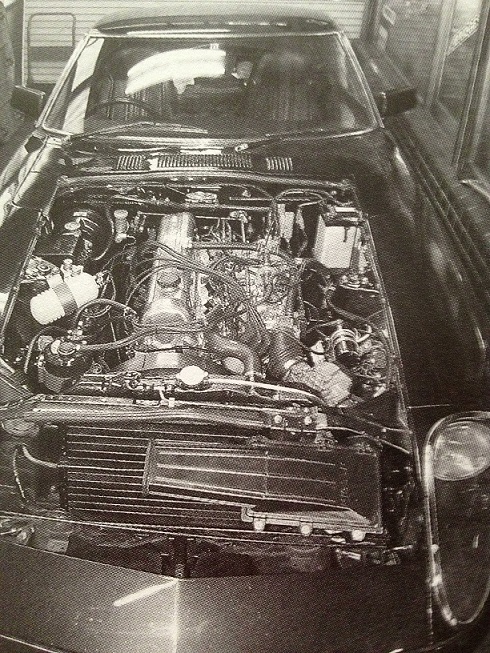

Hi all, I have installed my efi manifold from 280zx but not sure how to proceed with the installation of the air flow meter and filter, and where to put it.  if you have a photo or two of this It would be appreciated to help me work it out 260z with aircon. if would prefer to email thats fine just let me know.
thanks Linton
This is the only picture I could find in a magazine Linton, apologies for the poor quality. It seems to have the full ZX intake on it, ducting and all. The air filter is in the box which has been attached to the top of the rad support ahead of the radiator. The air flow meter is the light grey part behind the radiator support near the ignition coil.
To run it through in the same style as this you'll need to remove the vent duct in the front passenger side corner of the rad support. K&N filters are available for these on ebay too
thanks pretty much what I thought Gareth, still scratching my head a bit, actually its not far off finished if it actually goes it will be a bonus. funny all of a sudden I seem to be hungry  :)
