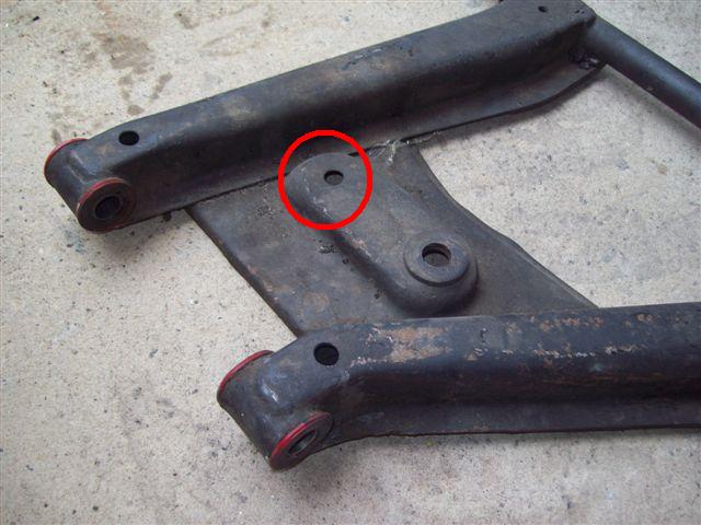

1. Does the hole shown in the photo have any operational purpose or is it just a likely location point for manufacturing?

Is the function of the hole for draining purposes? Price seems ok for the ebay bushes, i have a brand new set here but one is missing a metal sleeve.
Is it for the 'other' sway bar that mounts from behind the diff? Popular in the USA, but not sure if it was a factory option.

Nah, for sway bar that mounts in front of and below diff pinion flange, they bend bend back to then connect via drop links into the holes.
