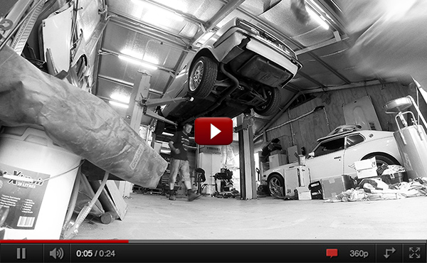

sexual_sushi Posted June 17, 2013 Author Posted June 17, 2013 Rear End Work Brad has been kind enough to loan out some time on his hoist and a hand so that we can get the 3.9 Subaru LSD diff in along with the RT diff mount, rear brakes and Wolf Creek CV's (on loan thanks to Brad again). Here's a timelapse of us pulling apart the rear end on the weekend (nothing too exciting) along with an awesome song from Brissy band DZ Deathrays <a href="http://youtu.be/CkrFta_AQM4"><img src="http://www.shaun-maluga.com/Images/Z/24tzd/ZWork_Youtube.jpg"></a> Quote

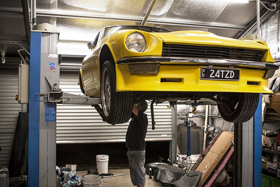

sexual_sushi Posted June 23, 2013 Author Posted June 23, 2013 Yep unfortunately nothing ever goes to plan. Thanks again Brad for staying up and working on the car until midnight Saturday. We got everything back together, subi diff in, cv's bolted up and disc brakes bolted on and bled the system a few times but couldn't get any pressure in the pedal. Not sure if it is due to the callipers being mounted 'upside down' with the bleed nipple on the bottom. A few guys posted on Hybrid that the system would be hard to bleed with the nipple facing down as the air rises, maybe they are right. So we are going to try and use a pressure bleeder tonight, maybe even disconnect the calliper and hold it the right way up during bleeding. We also have to adjust the handbrake, it needed to be nearly vertical to get it to engage and if we adjusted it the brake would be constantly on. Not sure if we will be able to adjust it out or if we will need to modify the handbrake. Quote

garvice Posted June 26, 2013 Posted June 26, 2013 In between qld's crushing halves over the nsw cockroaches, I decided to go out to the shed and give Shaun's car another go. I figured that it might go a little better without the whitworth/metric car god cursed Shaun looking over my shoulder. I also had a tool from PZG which helped (don't worry Matt, I only used the force which I figured would be appropriate for a hair dresser ;-)). Was a tough piston, but managed to get the final caliper piston compressed. Also, for you information Shaun, the cube type tool didn't fit the caliper piston the best. Was going to take it for a test drive, but had the 1600 stuck underneath (officially anyway). Just got to work out a fix for the hand brake now. P.S. Shaun, the LSD works well, you might need to some new rear tyres though. ;-) Quote
