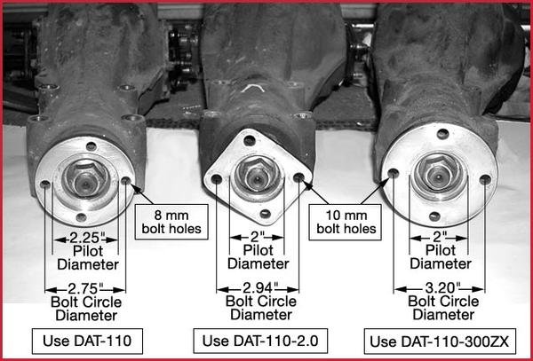

As im upgrading the gearbox I thought it would be a good time to put a bigger tail shaft in also.
Is there a flange that can either replace the standard front flange or bolt to it to support a bigger
rear uni joint instead of the small one?.
Or am I just over engineering for no reason?.
Paul
These are the diff flanges available for the R200
Either of the 10mm versions are good enough and you can get a matching flange for the large universal joint. The large round item is usually found on the R31 fitted with the R200 so that is the JDM versions.
