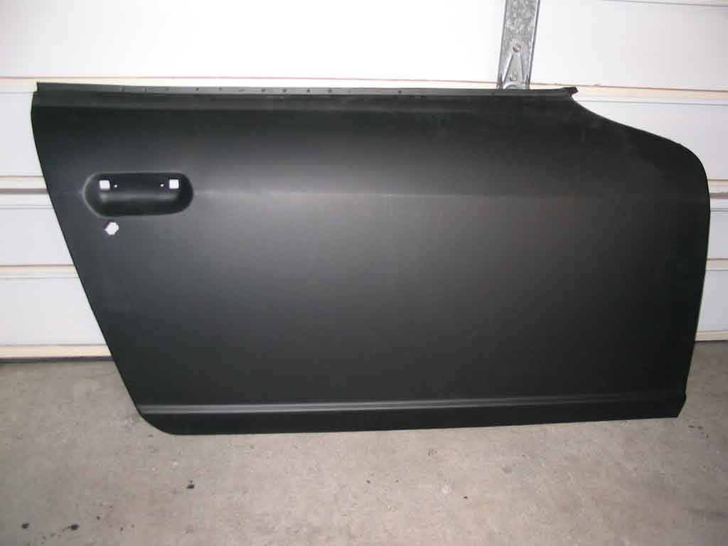

warrenz Posted November 23, 2005 Author Posted November 23, 2005 I have bitten the bullet and purchased 2 new door skins and a RH floor pan from AllZparts, arrived today. They said they changed the pressing a while back after complaints about the fit and not enough wrap around. They are pressed in Sydney. So hopefully will be OK. I did a quick check of the width and it seems the same as the door on the car. I was impressed with delivery and cost, next day and $30 delivery all up. In total over $100 cheaper than Zspares and it was delivered to my door. Holidays next week, so will remove old skins and see what the frame looks like underneath. Progressing slowly. Warren Quote

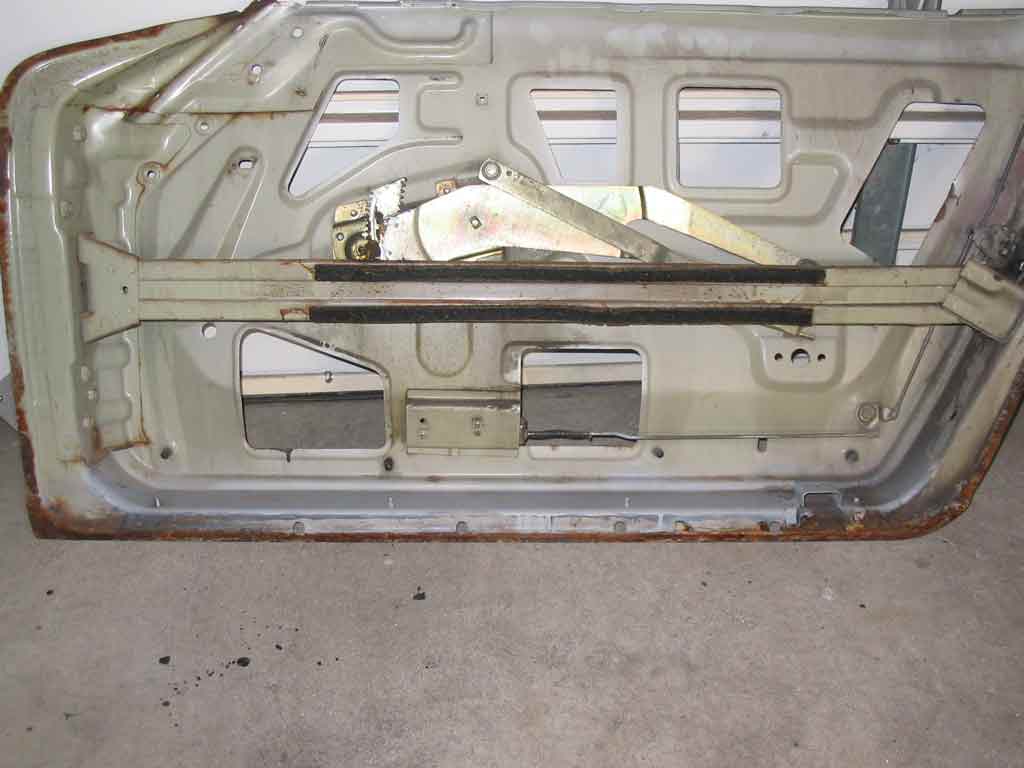

warrenz Posted November 28, 2005 Author Posted November 28, 2005 I think there would be no such thing as a rust free door. Took the skin off the LH door and even where it looked good under the folds it was rusty. LH door now ready for POR to frame and inside of new skin. Cheers Warren Quote
warrenz Posted November 28, 2005 Author Posted November 28, 2005 New skin ready to have POR treatment on the inside before fitting. Warren Quote

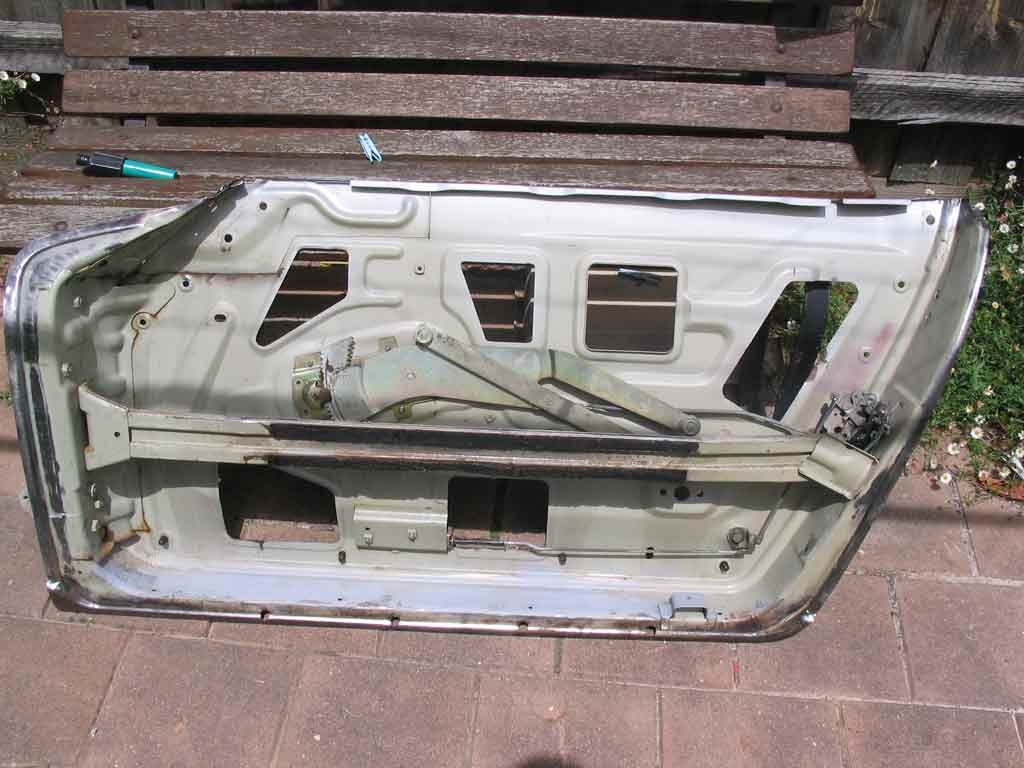

Mr Camouflage Posted January 12, 2006 Posted January 12, 2006 Your old door skin looked pretty good compared to mine What was the other side like? Heres mine: Quote
