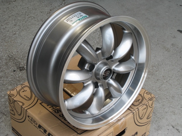

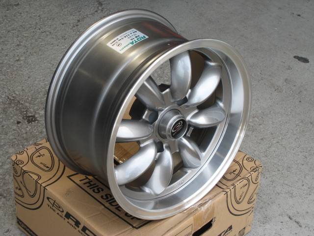

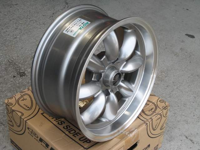

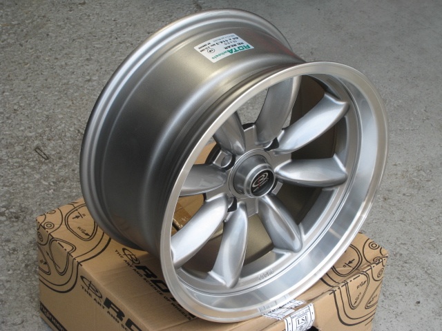

There may be something better; what are they?  Tokico Tanabe What will match my Koni sports. They must also complement my 16x7 Rota's with 205/55/16. Thanks
