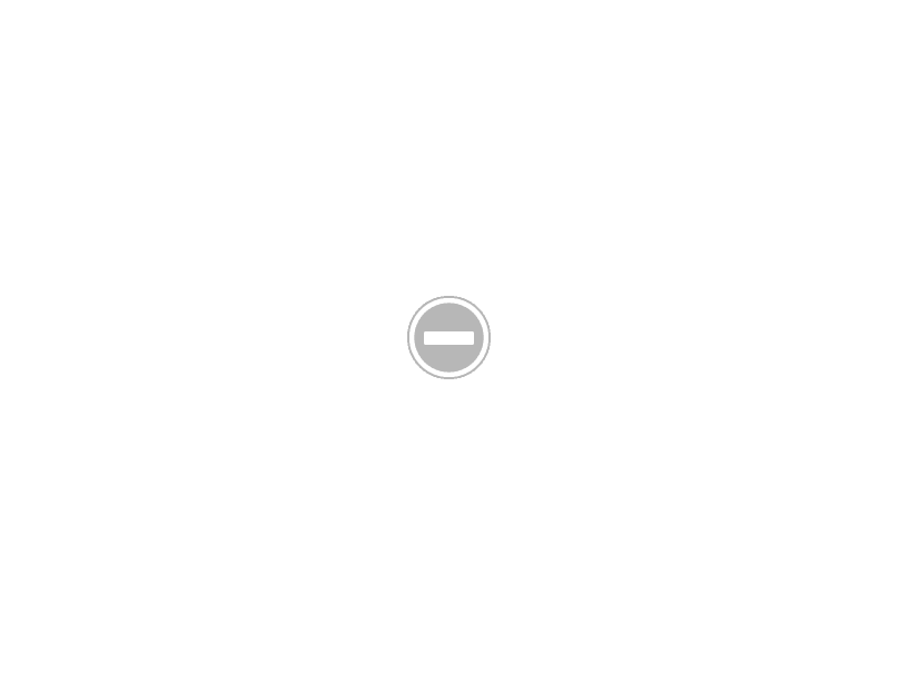

So to begin with this is what the clock and oscillator box look like.
0PEIhSOo9oFnDDROOcfVhvtDCOHSzw09i7wIAipdXuT-=w808-h606-no
These mounting photos were provided by Alan T (HS30-H) here:
http://www.classiczcars.com/topic/22917-rally-clock-clocks/?p=203553
The oscillator box is attached via a long piece of wiring loom, I had read that the oscillator is mounted on the firewall, but I didn't know exactly where?

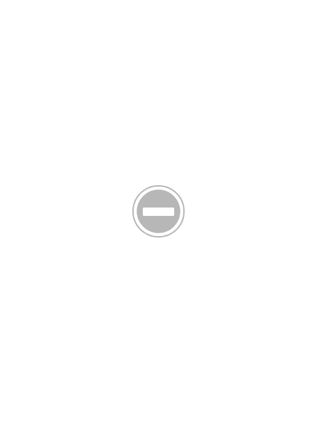

It turns out you need to pop out the little square tabs in the firewall insulation.
It felt weird removing something that had been on the car for 40+ years untouched and left there from the factory for this specific purpose.
Behind the 2 tabs are bolt holes and from the diagram above it looks like the screw that fits into them is the same as that which holds the 3 center gauges into the dashboard.
I brought 1 spare with me from another dashboard I have.
y64ttaEooD10v8S6v9b647A-c-EOdBgvywABUVhKiiW7=w455-h606-no
But I didn't have the same for the other side of the bracket so I used another temporary bolt for now. I'll get another 1 of these bolts for the other side to match later.

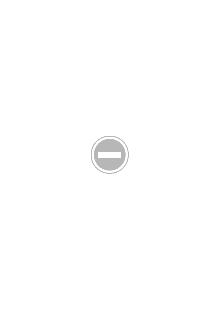

On top of the oscillator box is a label that says UP, which means mount upwards obviously.
So I did just that ;)
Next I installed the clock, I removed the old clock as you would any other gauge. The tricky part was getting the now polished and scratch free Rally Clock into position without damaging it. This was actually a little tricky and I had to turn the clock on it's side get it near the gauge pod hole and then turn it 90 degrees again to face the front of the dash and I managed to put it into the gauge pod without any damage etc.. It seems the clock has a little less space around it mainly because of the glove box.
Then I screwed the retaining nut into place and put the globe in as with any other gauge. The only difference was that I had to plug the oscillator loom in also. So I had to feed the loom over and around the heater/fan blower unit and it was the perfect length to plug right into the oscillator.

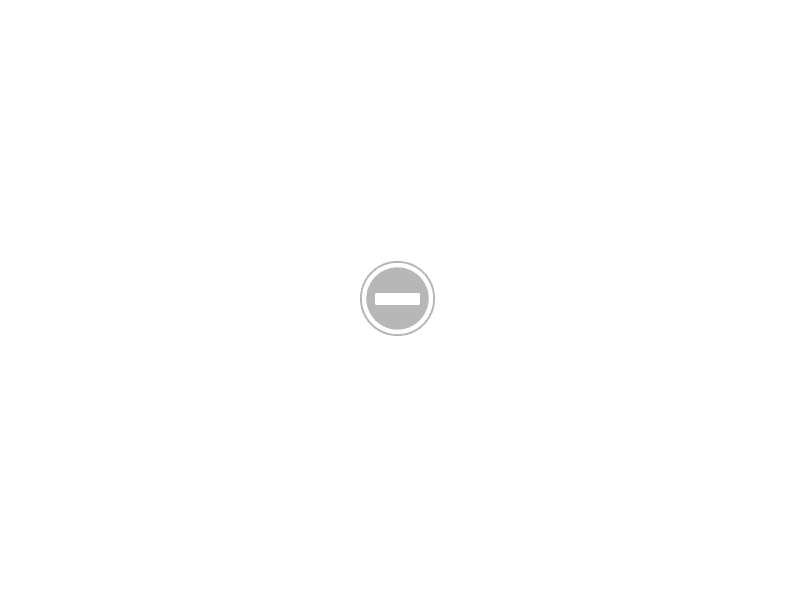

How it looks installed on the S30z.
Finally I put a small little video together to show the clock working and in action and how you use it. Which is basically what this image shows.

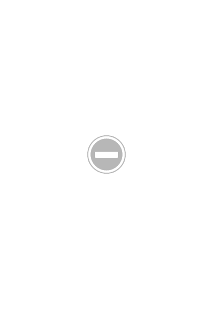

I figure this was probably the most relevant place to put this, here is a photo of the internals of an oscillator box (you can see the tuning fork) and all components used in it.
a9vAfqcDxdgb65xgTzX_JGKHGh6CnAKOndc8z8qD-zln=w796-h597-no
The tuning fork is quite unique apparently where as the rest of the box is relatively standard 1970s electronic components.
