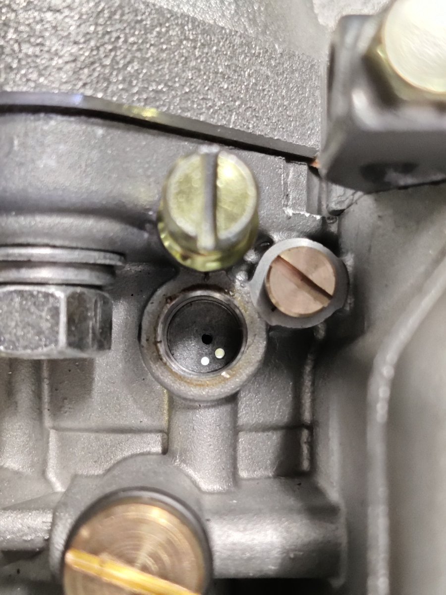

Hey Andbir, cheers for the write up! Just checking, is this what it should look like when you say 'throttle plate covering the first progression hole'? I've shone a light down the intake to work out where the plate sits. I haven't seen any guides that mention setting the idle like this, I'd only heard of going in 1/4 or 1/2 from where the idle speed screw starts activating the arm. Setting it like I've done in the photo is about a full 2 1/2 turns in opposed to 1/2 a turn in? I'll report back once I've been able to fire her up again but I wouldn't have thought to increase the idle speed when I'm already idling pretty high and rough.

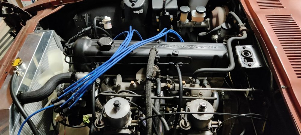

So, unsuprisingly, a new set of carbs didn't magically get the car running decently. After installing everything and trying to dial in a baseline tune it ran worse. A lot worse. Backfiring from the carbs and the exhaust, idling at 800, then 1600, then dying, it was all over the place. I tried all the usual things - adjusting timing with a timing light, attempting to sync the carbs, adjusting idle screws, running it with / without the aftermarket electric pump, checking for vacuum leaks...but no success. Putting a syncro over most of the air intake tubes killed the thing and it was so hard to keep it running consistently that I couldn't work out what to even attempt. I gave up for 3 months, apparently, figuring that I'd have to send it off to someone who knows a lot better than I do. But now, with a house move to a place that has an incline driveway looming (meaning the car needs to be driveable to be able to get it up the driveway to store it), I figured I'd do a last run of somewhat methodical tests. The first idea was to drain the (possibly) old fuel, just in case all it really needed was fresh fuel. When I unplug the fuel send port on the tank, the fuel almost just dribles out. The return post sends fuel flying out as you'd expect. So, first question - is that to be expected? I've got a late model 260z tank, so as far as I can see the send port is driver side, return port is passenger side. Ignoring that, the second test was to work out what sort of fuel pressure I was getting - perhaps inconsistent pressure was causing inconsistent running. I'd bought a PSI gauge, so may as well use it. With the key in the 'ON' position, the aftermarket electric pump makes a big racket, but does functionally nothing. I tried switching tank outlet ports, fuel lines, fully charging the battery, and also blowing compressed air down the lines / tank ports incase there was a blockage (there isn't, as far as I can tell). The electric pump should definitely be able to prime the whole fuel line on it's own though, right? Even with air in the lines, it should still be strong enough to push fuel from the tank to the carbs with decent pressure? Or am I asking too much of it? Not knowing the answer or wanting to buy another electric pump without doing more testing, I decided to take off the pump and blow / suck air through it. I wanted to know if I had the pump wires disconnected, or the pump was broken, was it actually blocking the line and stopping the mechanical pump from doing it's job? Turns out I could blow air through it, but it makes a sort of trumpet noise at the start - like there's a bit of resistance but then a gate stays open once the fuel is flowing. I could probably look into how these things work but for now the tests continue. Next test - seeing as the triple carb set up has never been trialled without the electric pump after the tank, how would running just the mechanical pump go? Plenty of cases of people just running the stock mechanical pump with triple webers it seems, so worth a shot. After a long while of turning the engine over (side question - is it bad to keep the engine turning over without it firing up? How much damage have I already done over the years?) the single, dead head line was primed with a consistent 5 PSI. Eventually I throttled the carbs and it fired right up - revving straight up to 2000 rpm, sitting there and backfiring a little. Not wanting to touch anything and hear it backfire all over the place today, I've turned it off for the day to try and work out the best way forward again. I've got to wait a day for the threadlocker on the fuel pressure regulator ports to set, so I'll charge the battery again over night and adjust the idle screws on the carbs a little before firing it up tomorrow hopefully. If it runs consistently, then perhaps I can at least start to dial in a tune? I also realised I got distracted and never ended up draining the tank, so it may still have stale fuel. So - last question - can I install this non-bypass, dead head fuel pressure regulator between the mechanical pump and the carbs like I've got pictured below (with the routing of where the clear hose goes, just with everything connected properly)? Supposedly the webers want 3-3.5 PSI, and the mechanical pump seems to be giving them 5 PSI. Originally, I planned to use the FPR with an electric pump installed after the tank and a return line just coming out of the third carb to keep the fuel lines cool in traffic. Will the FPR mess with the mechanical pump? I imagine the mechanical pump will push fuel regardless based on RPM, but if the FPR is restricting flow right after it, then how will the pump respond? One day I'll be able to post simple updates, but for now it seems all I've got is questions and more questions, so if you've made it this far then sorry, and thanks! As always any help is really appreciated.

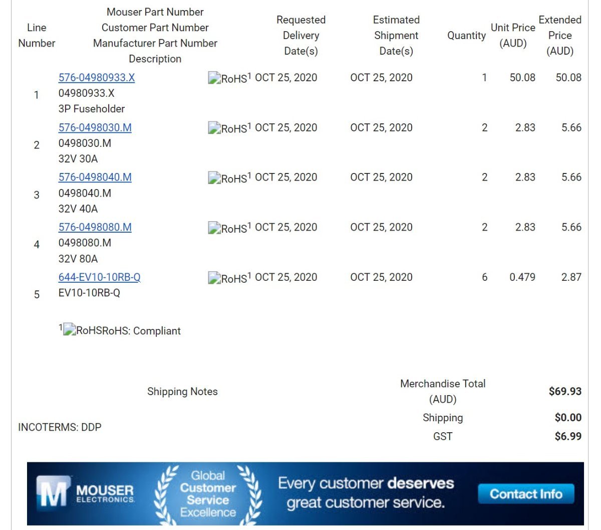

Hey Rudi! Sorry, I only just saw this post - not sure if it's helpful anymore but here's the fuse box I installed: https://au.mouser.com/ProductDetail/Littelfuse/04980933X?qs=sGAEpiMZZMvShe%2BZiYheii%2FeEXsvxFUx9RjL22D3SL0%3D&countrycode=AU¤cycode=AUD And here is the rest of the order I made at the same time with the part numbers for the fuses:

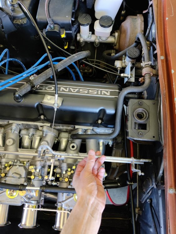

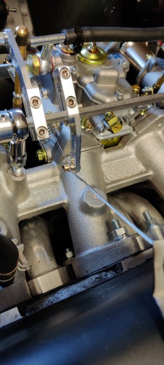

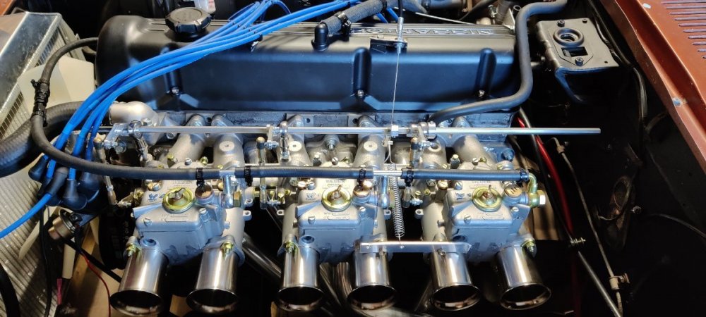

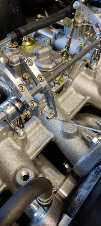

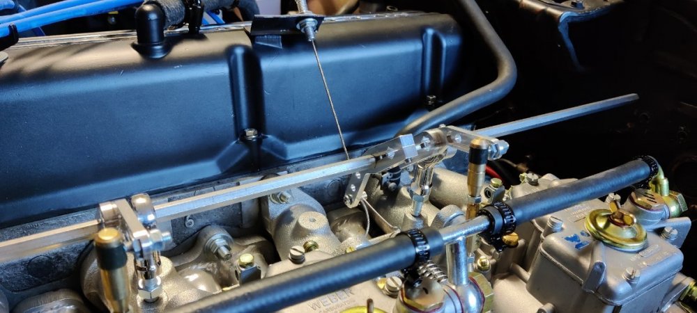

Cheers for the suggestions guys. Spoke to the guys at Recarb today (super helpful folks, great to deal with) and they'll be able to send a cable clamp that should work with their linkage arms better than the generic one I've got in there now. Hopefully that'll give good results, but if not then I'll definitely be getting a donor linkage and adapting to suit.
Perhaps it's a 260 thing then, but I couldn't see any solution with the original linkages that wouldn't at least involve me cutting this section down (it's just too long as is) and welding the new hex rod to it. Can be done for sure, I just wanted to avoid it if possible so I can easily revert back if I ever needed to for some reason?
I already had a throttle cable conversion kit with a bunch of cable ends, so I thought I'd try and get that working to avoid cutting up and modifying the original linkage and getting it to work with the new set up, just in case I needed it in its original state one day...
Well, I've finally gone and got some new carbs as per pretty much everyone's recomendation. I ended up going with the Weber 45 DCOE carb / manifold / linkage kit from Recarb and hopefully will be able to get them running tomorrow. Just wondering - does anyone have a solid way they've attached a throttle cable to these carbs? The linkage uses a hex rod, so I can't find a pulley that mounts straight to that hex rod (like how the Kameari / Haradi set up works), and I'm not sure whether I want to be attaching a pulley / bell crank to the centre carb that then somehow actuates the other carbs (seems like that would be inviting unevenness actuating one carb first instead of actuating the whole hex rod from a seperate arm?), or whether there's some other option I'm missing?
