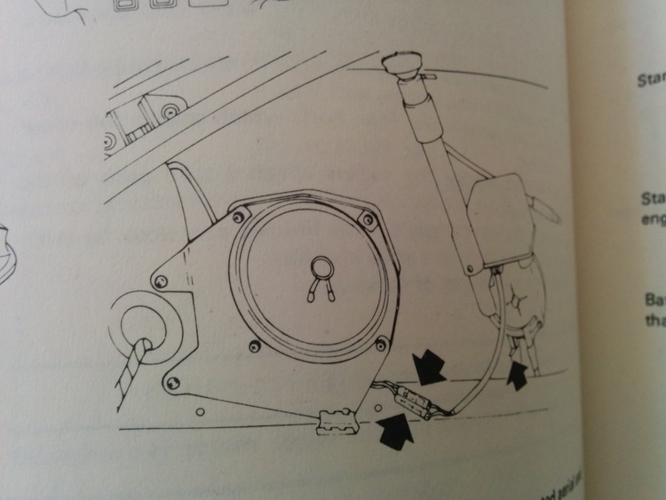

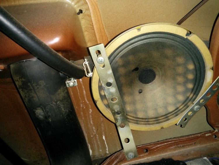

  11. Hello Everyone, I was wanting to install new speakers in my 240z as currently the speakers are 6x9 in boxes sitting in the boot which i don't like as i would prefer a cleaner look. According to my Haynes manual the original speakers have some sort of mounting bracket i can't tell what size they are i'm assuming either 4' or 6'. I pulled off the trim and found that at some point the speakers have been replaced but are now mounted different as shown in the photo. Does anyone know what the original brackets look like or know where to get them?
