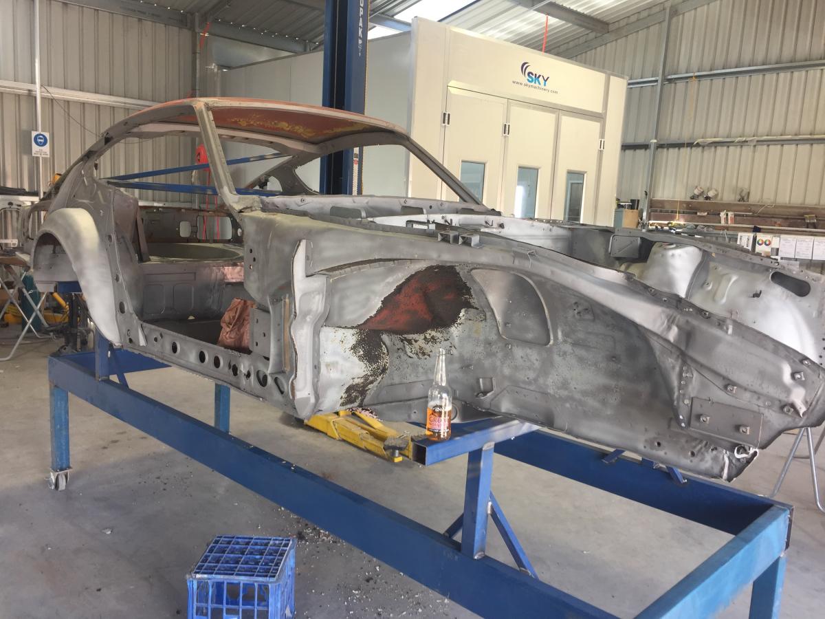

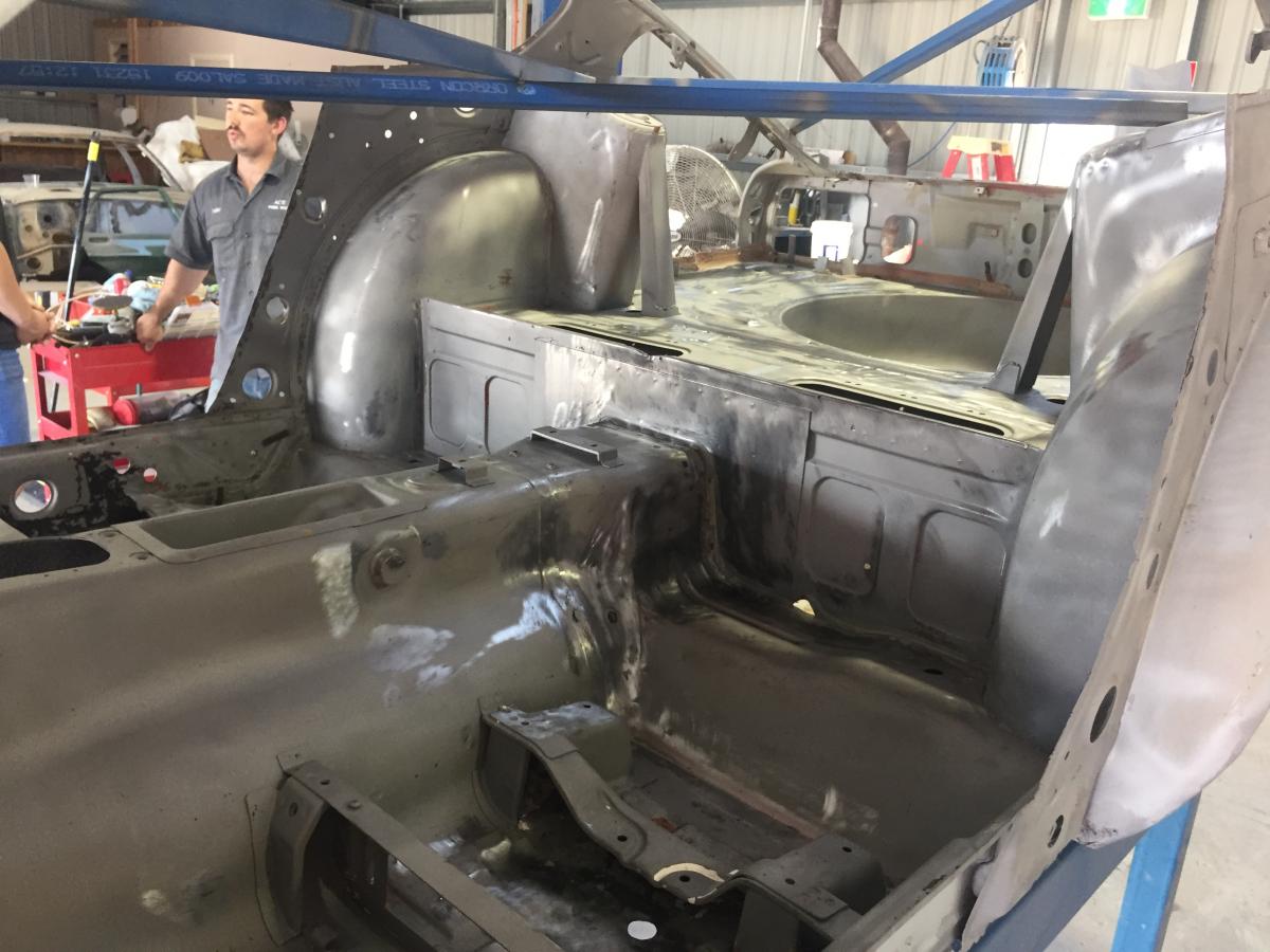

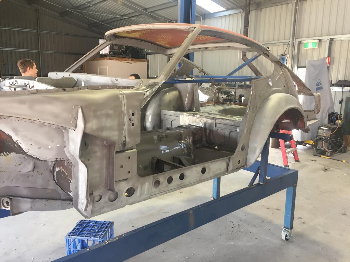

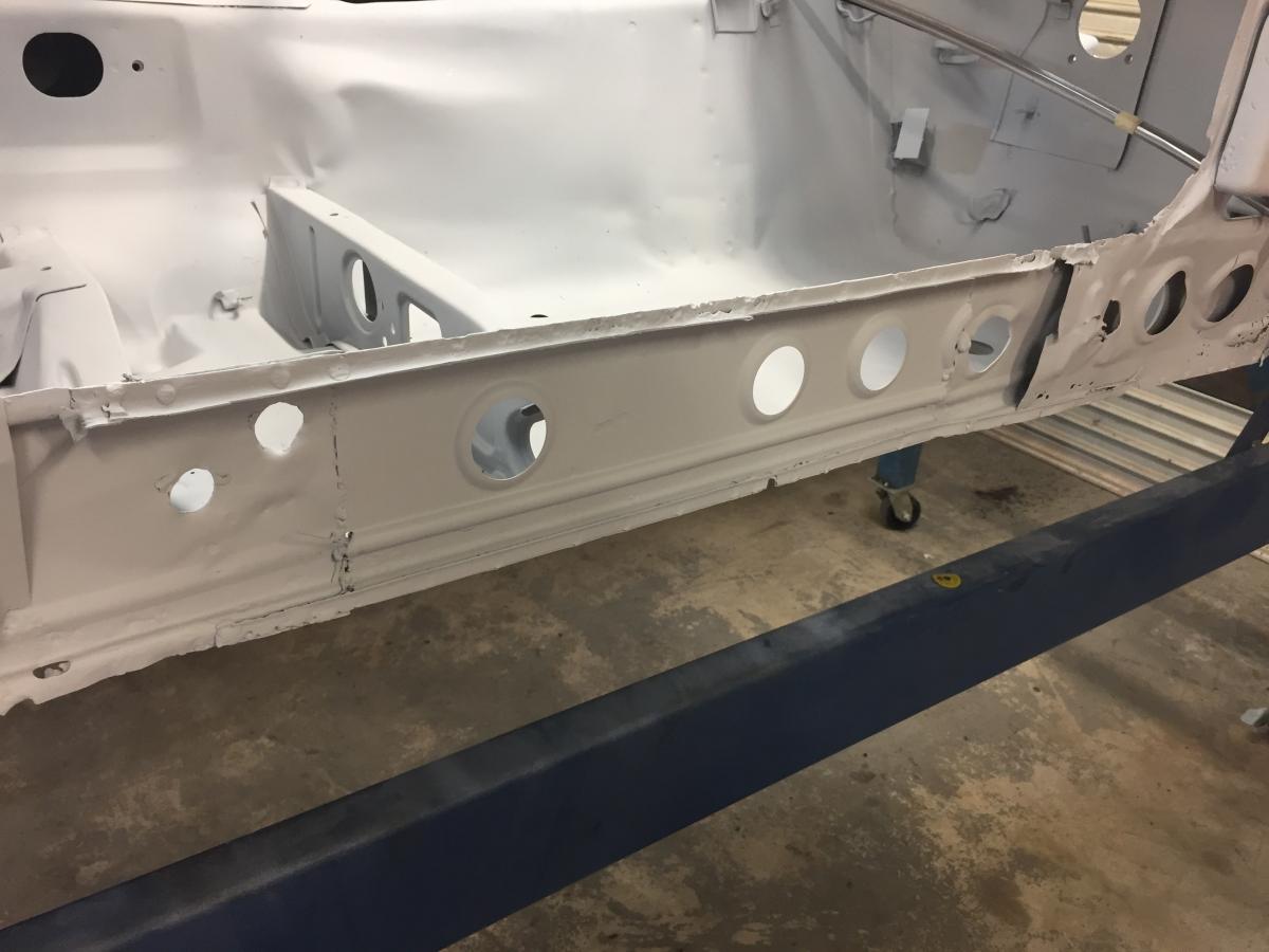

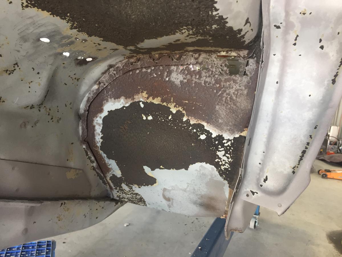

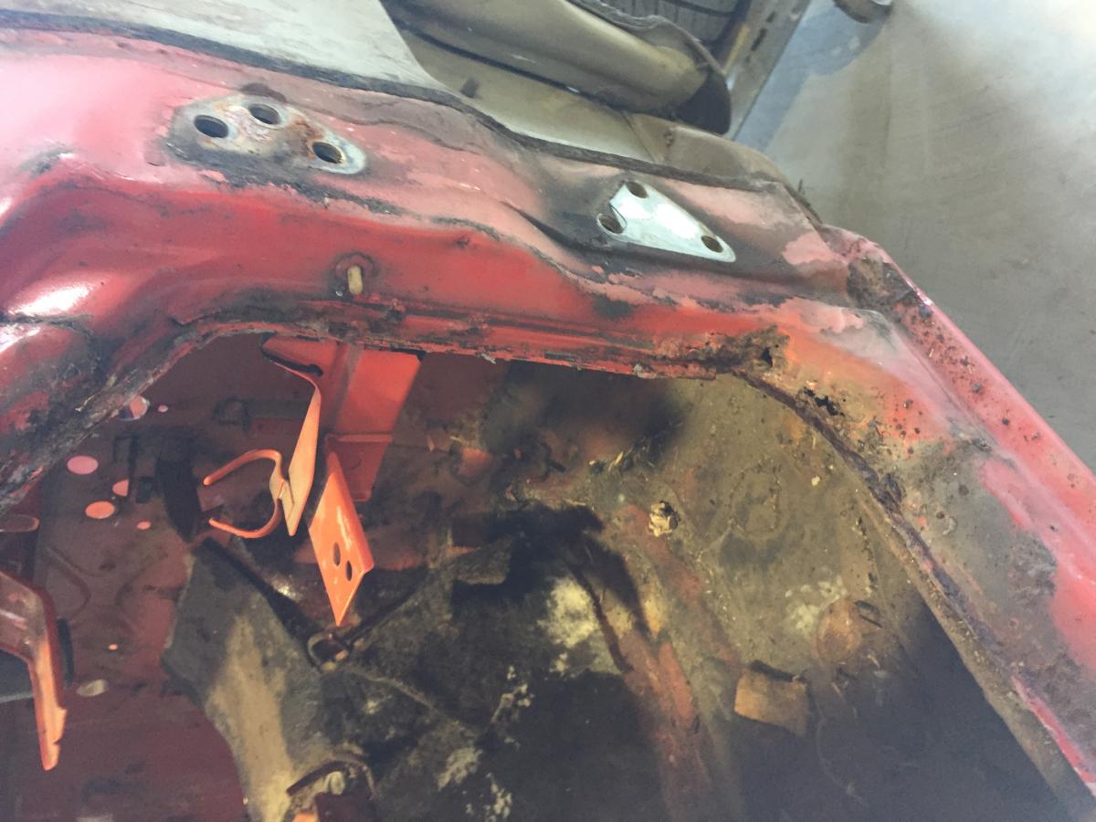

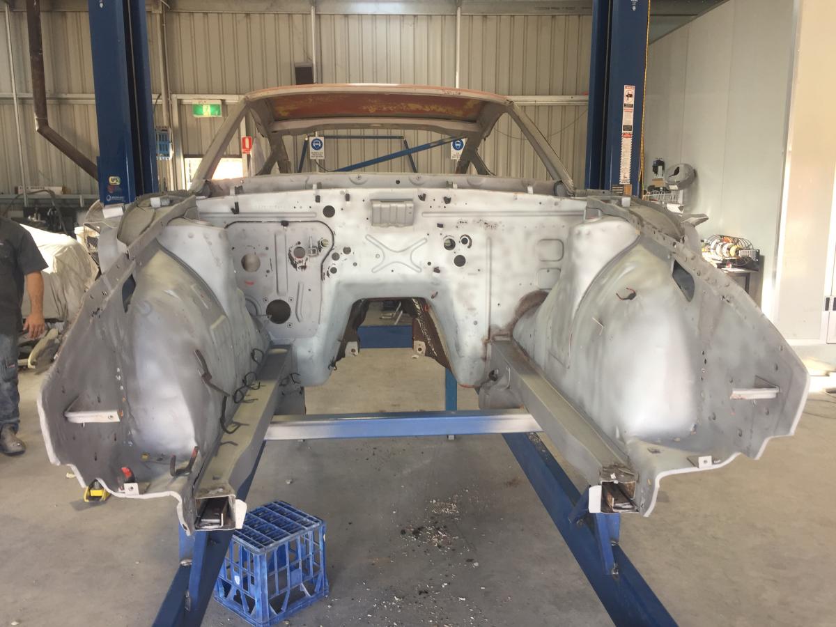

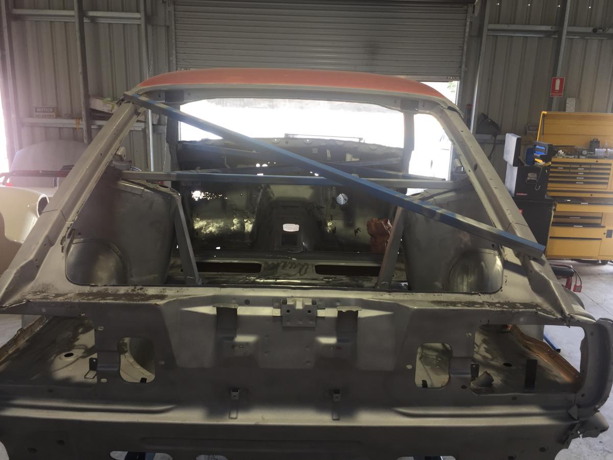

  9. So its been ages since my last post and there's been a fare bit of progress. The car has been completely stripped to a rolling shell and handed to my panel beater for blasting and all hanging panels off. He talked me into taking off the rear quarters when he saw the dog legs and a small amount of rust on the rear window surrounds. BEST DECISION EVER... As you can see from the photos, if we hadn't taken them off i would've been looking at bubbles on my nice new doglegs in 3-5 years. Other areas that came to light were the passenger foot well/ lower battery tray, beneath the slam panel, where the A-pillar meets the inner guard, and once all the leaves were vacuumed out from under the beaver panel there was a square box that the blower motor bolts to that was rat s*#t... and just a touch on the firewall. Also found that the car has been in an accident at some point in its life and a pretty shitty attempt at a repair been done on the drivers side, floor is a little beet but easily fixed. So a bit more than i first thought, I'm a little disappointed by how much was found in total but its not the end of the world.
