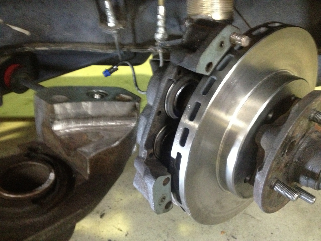

[FOUND] Got some brand new DBA Magna discs ($45 each!!!), which are 6 mm thicker so supposedly better at cooling than my current Honda Legend ones. They are at the machine shop now. Mechanic advised me he has shaved off some of the inside of the calipers to make it fit which is not documented in the sticky for hilux conversions but who am I to argue...

Guys, it has not been a good week for the Z! I completed the Hilux / 4runner conversion about 10 years ago, using a Honda Legend vented disc which we machined down the outer diameter, increased the inner hub hole size and redrilled the bolt holes to fir the Z hub. These discs are now stuffed according to Mr Mechanic and are too worn to be remachined. Does anyone have any vented discs that have already been modified to fit? If so, please PM ASAP as otherwise I’ll have to buy some new discs and go through the process of having them machined etc. Thanks! Lee

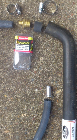

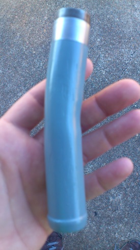

So, another Saturday has passed and I have done some more work on the Z. I am of course delighted to share with you all the progress made on this most exciting topic! Now the tube has been painted, I tapped it in with a hammer, using some wood to protect it. Then I needed some hose to get the tube to the new catch can so off to Repco I went. Here's the issue, the crankcase breather tube is 24mm and largest hose you can get is much smaller than that, not to mention the fact that the input for the catch can is really small. So after staring at everything available for quite some time, I managed to assemble: an AU Ford radiator hose (fits over the 24mm breather tube and has 2 bends which were useful in getting the best alignment). 1m heater hose 3cm of slightly larger heater hose (small slice I got for free, need it to step up from the 1/2" adaptor to the 24mm rad hose) 1/2 to 1/4 inch brass adaptor clamps Picture 1 shows the parts lined up. Picture 2 shows the rad hose with a 80 degree bend on the tube with the adaptor fitting. After some fiddling I got this all to fit alright, but my idea of putting the filter on the catch can is not possible because the filter fouls on the hose! [Picture 3]. So I am still not finished. I'd like to connect the breather on the tappet cover to the same can, using the other connection, but then there is nowhere for the air to escape. So I'm thinking I will drill a hole in the top of the catch can and then use one of the spare fittings that came with it, weld it in there somehow [Pic 4] and then put the filter on that. Then I will be sorted! All I need is some way to weld aluminium and it should one day look like the final Pic 5!
Last weekend I managed to get the new crankcase breather tube sorted. I know for most people, the crankcase breather tube is one of the most important components to consider in your Datsun restoration, and it is for you that I provide this account of progress so far. I gave it a wee sand with an old file I had and some sanding blocks I had left over from sanding a wall. Then I whacked on some machinery paint I had left over from etch priming my front door frame on the house. And now it looks the business! If only the other engine bay bits looked so nice! Lee
