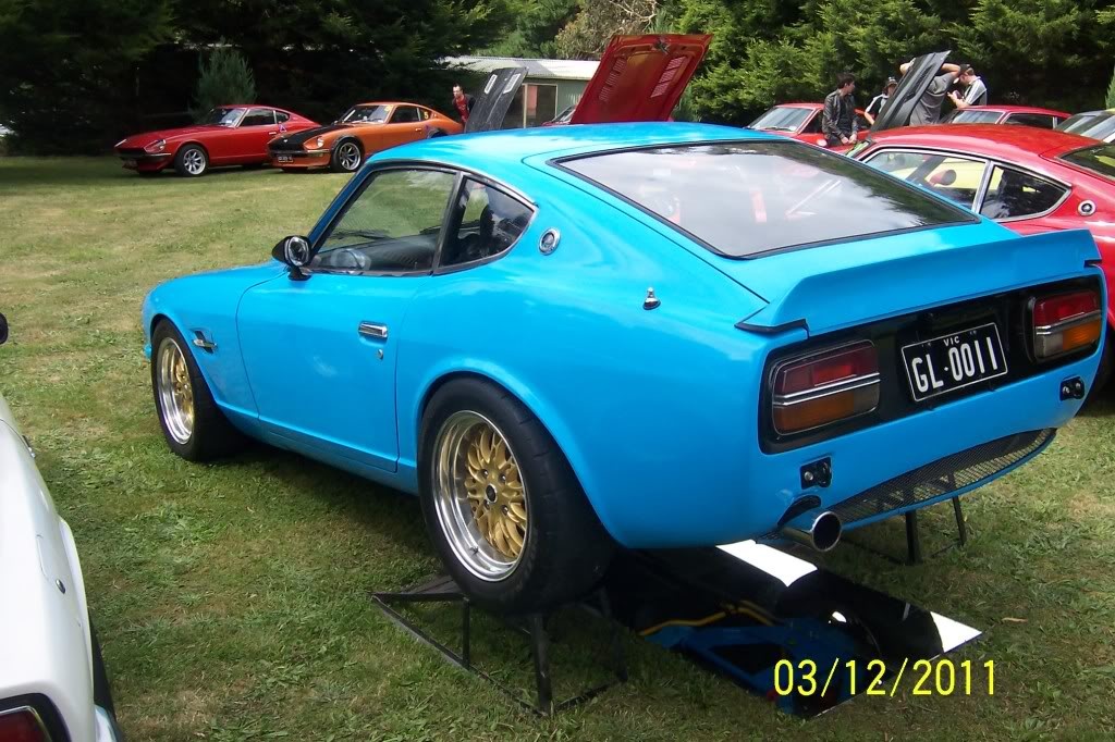

  1. Some of the things I added. Just because. Rear tow hooks made with a chain link welded to backing plate and powder coated. 260zed switches put into the top of fuse box lid. Alloy peddle covers. Recessed front guard indicators. Shortened front bumpers. Rear quarter interior panels moulded to fit speakers. Battery cut off switch. Full hight grill. Front tow hook. Recoil seat belts. Nissan Silvia front seats. Rounded rear quarters. (No bumper bar ) Fluted bonnet. Speedo in kph. Fresh motor. Adjustable coil over suspension . With Bilsten shockers. Disk brakes all round.

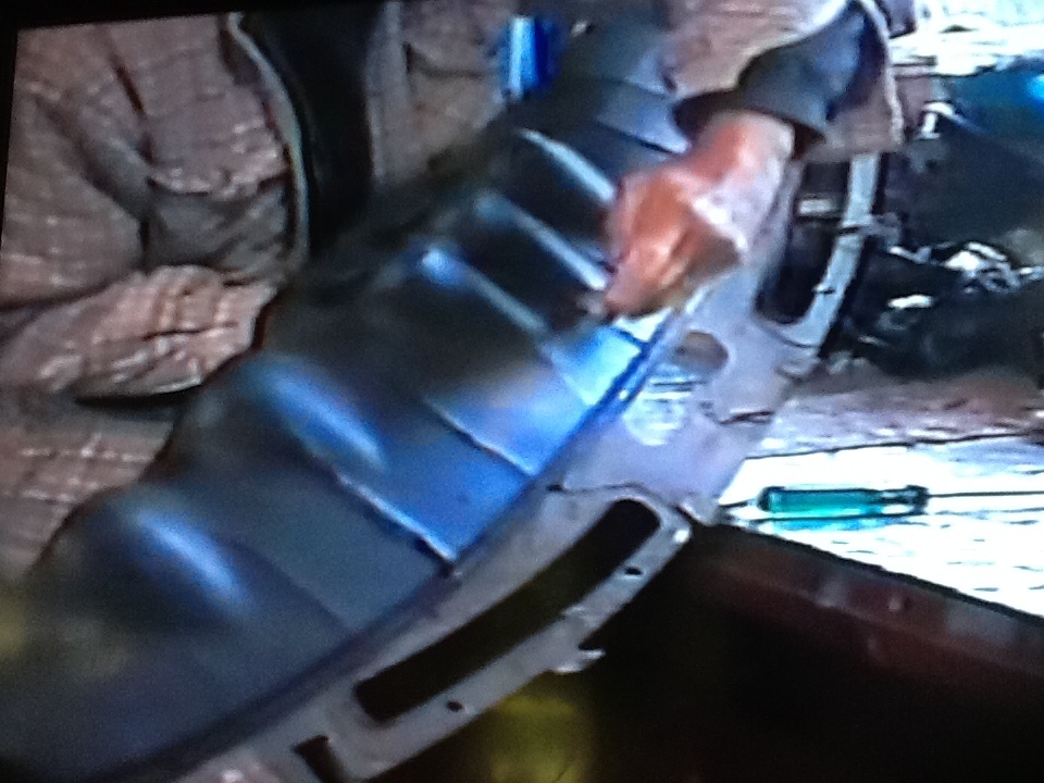

  8. Some other things that went into this car. I' wanted to do a grill with a few more blades in it. The full length of the radiator opening. Wasn't that hard, striped the grill and took all the blades out. Welded extra length to the upright blade holders and added three or four more blades . Then it was decided to cut the middle or the bumper bar out to give the full grill look. So little quarter bumpers where made. The door trims where made when the seats where done in the same material . Front and rear spoilers where fitted. The gold ROH Wheels off the red zed fitted nicely . 16x8 front and rear. After all these bits where fitted it was time for the engine to go in. Pictures are lowering the car down off the rotisserie with the wheels on and getting ready for the motor.

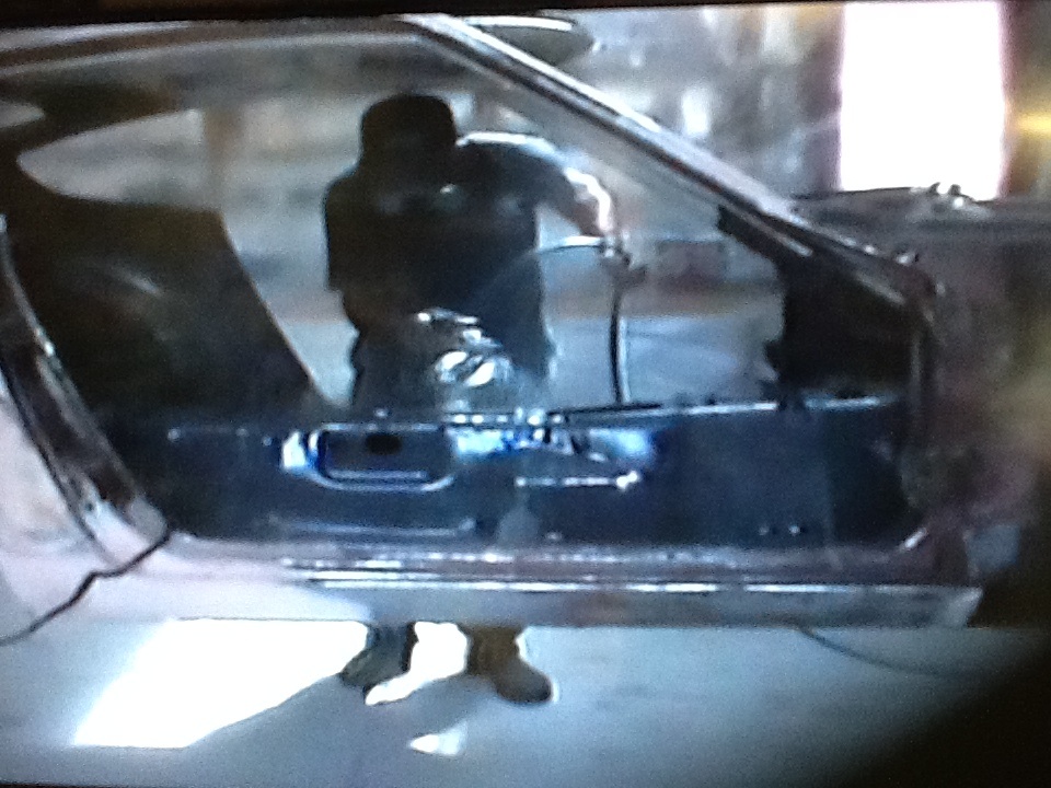

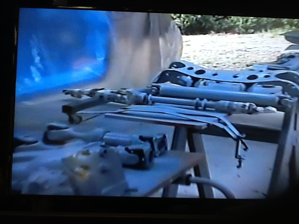

  11. Front struts and shortened with coil overs and Z32 callipers.

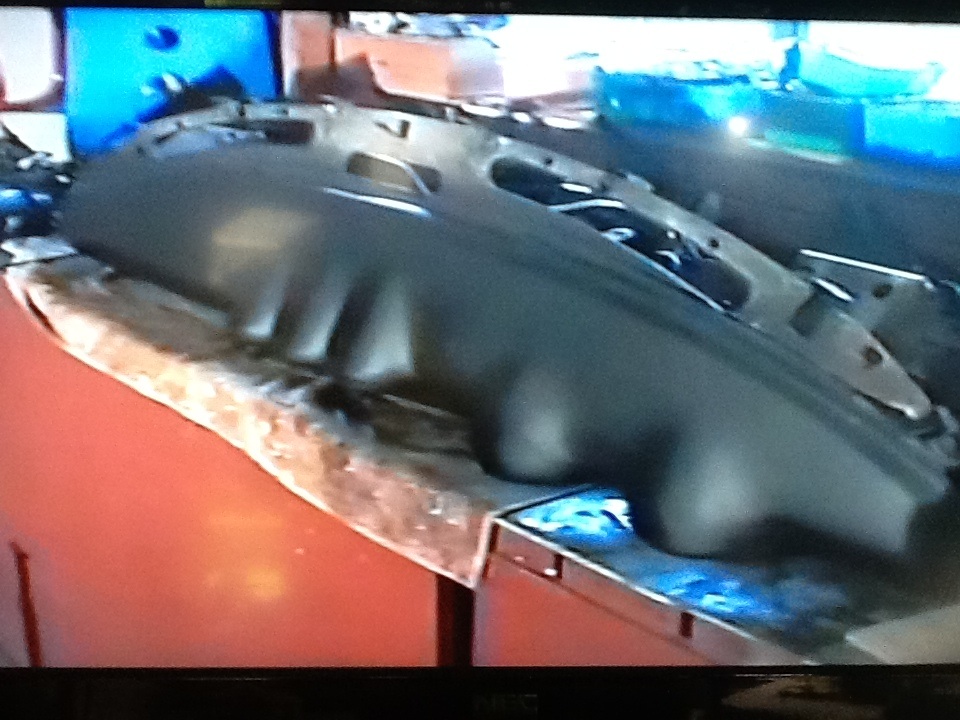

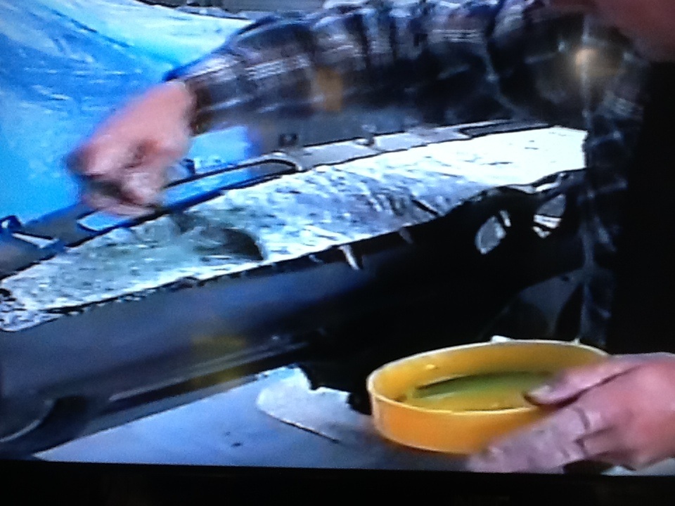

  12. Suspension was going to be totally up graded. Front lower control arms where made buy cutting the old ones and welding in threaded nuts and using aero grade rose joints. This would give me adjustable camber . The front brakes would be Z32 four piston callipers and vented discs. I cut the strut legs down 50mm and used adjustable shortened Bilsten shocks. Welded on some threaded coil overs with smaller diameter springs. The rear strut legs got the same treatment with the Skyline R31 rear disks and hand brake. Pics are the front control arm with rosé joint. Also a well known suspension mod is to relocate the mounting bolt for the lower arm that will give you more neg camber and help get some bump steer out of a zed that been lowered 50mm. Other pics are rear suspension mods.

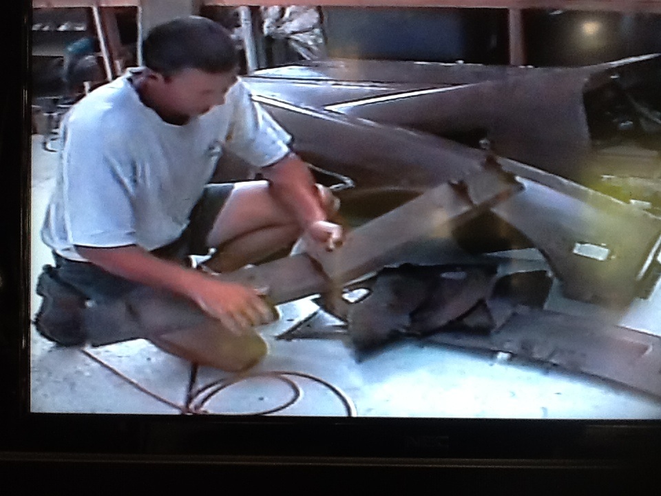

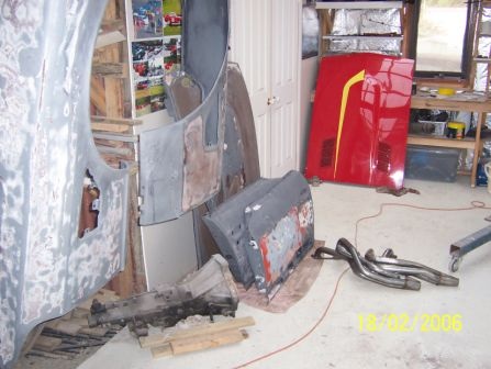

  14. Your right Simon. It's a bit wearied. It was 95% finished at the end of 2007, but never finished and it just sat there in the shed because I didn't really need it. The only reason I'm doing this is to share some of the things I've learned over the journey . And I like doing the thread like this. It won't sit for months with nothing happening. lol.

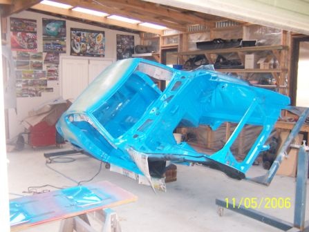

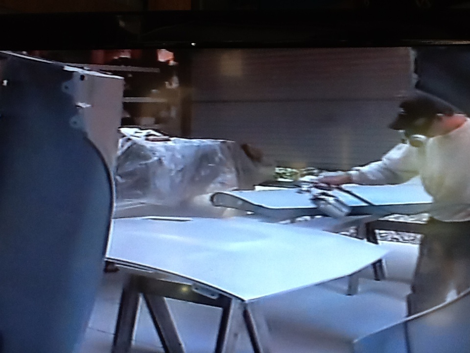

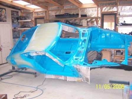

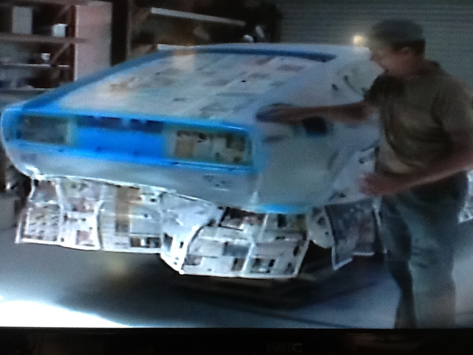

  15. While waiting for the body to curer or dry in the hot summer weeks I tackled all the other car parts and prepped them for paint ,powder coat or just restore. The two pack undercoat was rubbed back and some parts needed a little more attention . The colour was chosen straight of a Paint chart. I liked the bright sky blue , picked the colour and that was it. The inside was painted first then the out side. After a few days a plastic cover was put over the car and paint began on all the other panels and doors. I went to the trouble of hanging drop sheets from the shed walls and ran water through the shed floor to stop dust getting air Bourne .

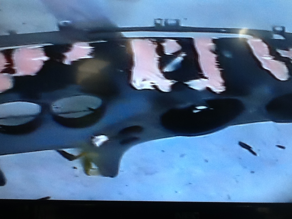

  16. Now all the panels and parts where in under coat I wanted to give the body filler some time to cure and shrink if that was possible . So time to move to other jobs. The dash board. This was the typical dash . 4 or 5 cracks. Time for a re skin. I'd prepped a dash before and new the steps. First was the groove out the cracks so the body filler would hold. Fill and sand back to shape. Fiberglass one or two sheets over the top of dash. Then go with a thin coat of filler again and sand to shape. The Fiberglass is the strength and will not crack again. Now it's ready to be re skinned . These days the wraps are good enough to heat stretch to shape. Job done.

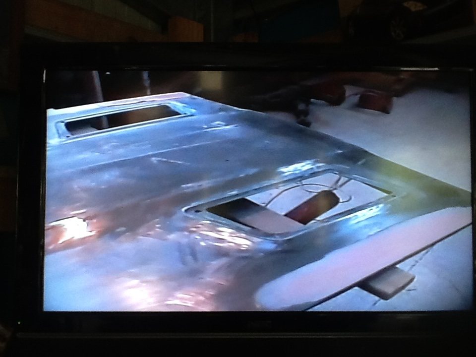

  17. When the bonnet came back I was a little worse than expected. The parts car was looking a bit better and also had the fluted bonnet that would suit my kind of build. The hatch was in good condition and required minor work.

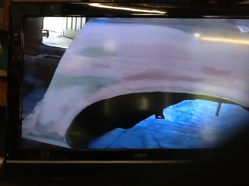

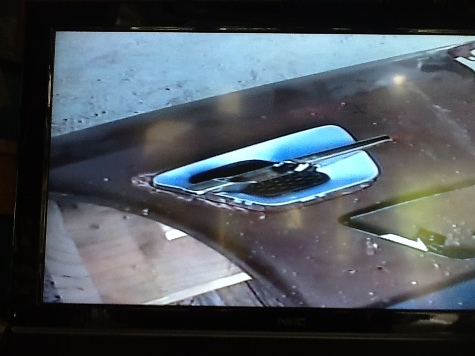

  18. Now that the body was in under coat it was time to focus on all the other panels and doors etc. the doors needed rust removed from the lower edges, so after rubbing back and paint striping it was decided to take all the lose panels to a mate for sand blasting. This way everything would be revealed and no surprises . The front guards needed rust removed from the lower sections. I also filled the forward indicator holes and mirror holes. One of my little modifications was to put the Holden indicator in the front guard . This was a bit of a gamble but I think it works ok.

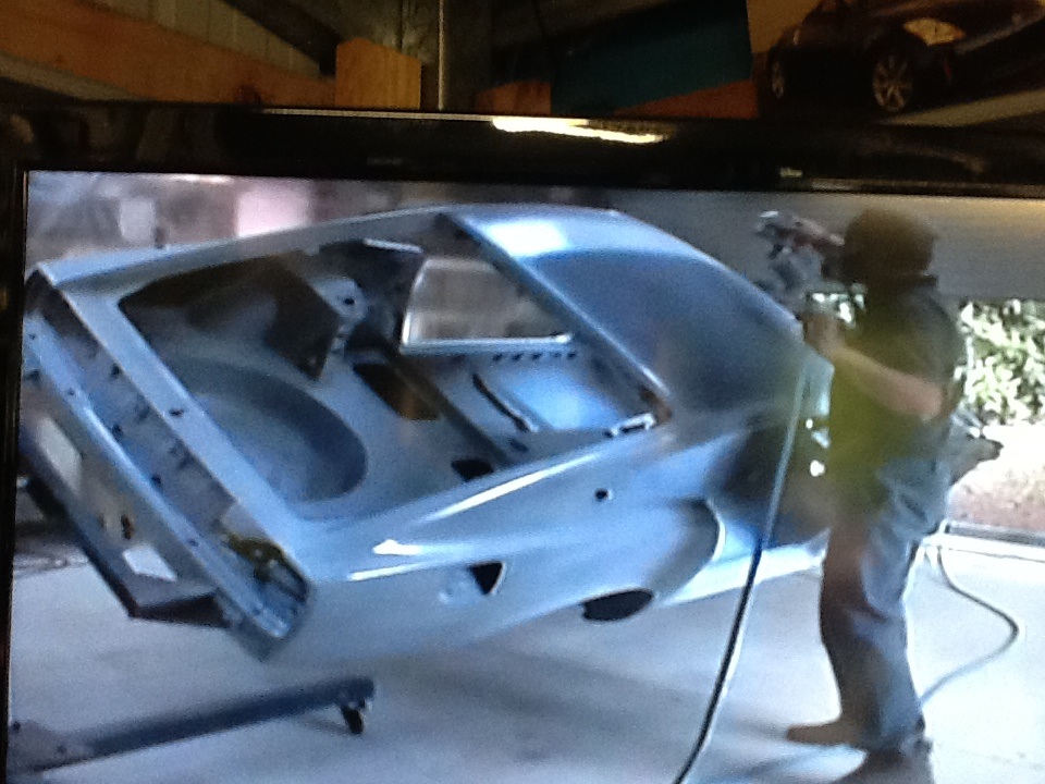

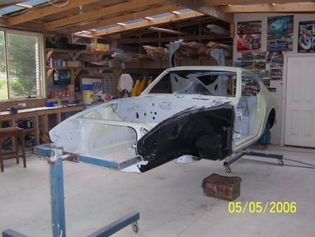

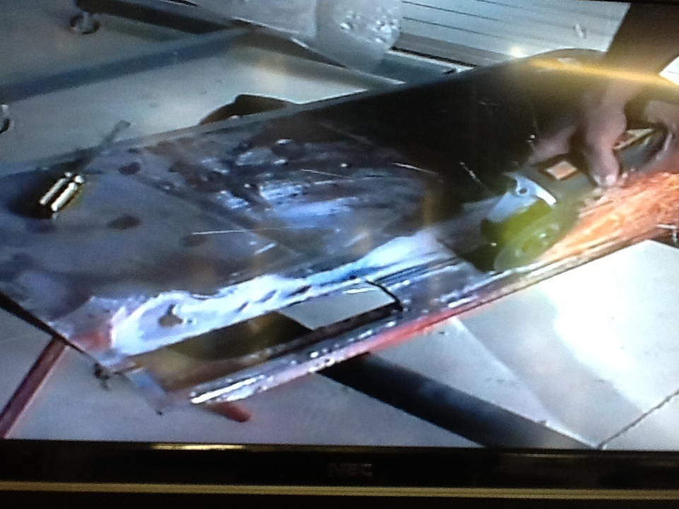

  20. On the inside all the body deadener was removed. And in the rear luggage floor area I used some body filler to smoothen out the creased body work. I welded steel plate over the top of the rear shocker tower to clean it up. After weeks of filling and sanding the edge primer was sprayed on. Was such a relief to get the body all sealed up and not having to worry about moisture and surface rust a peering .

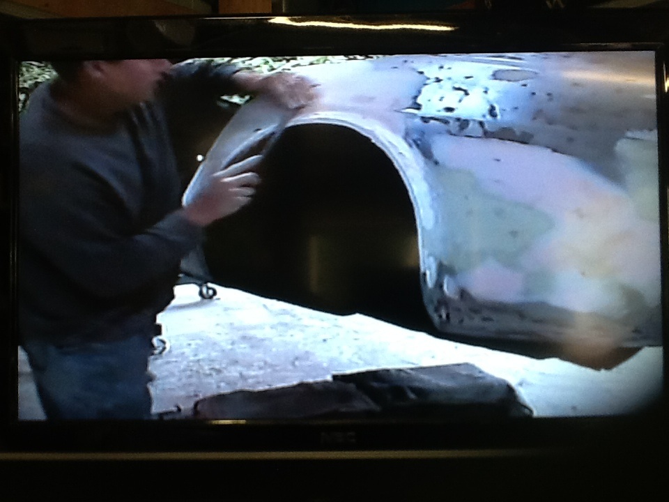

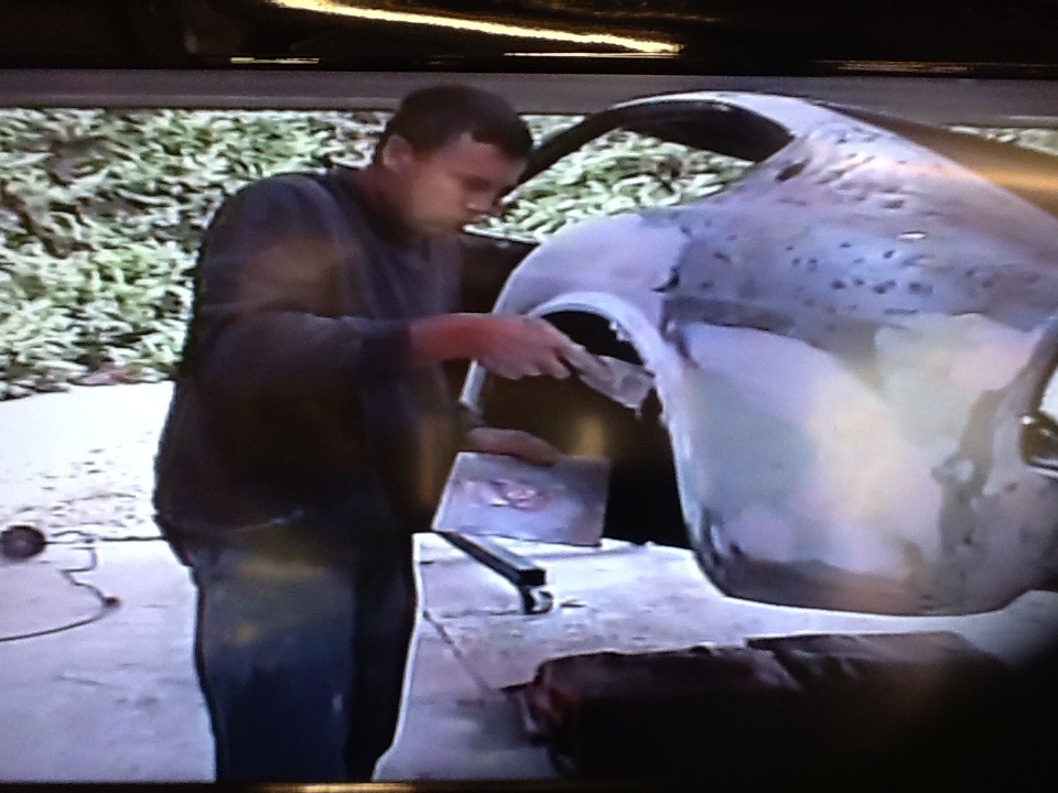

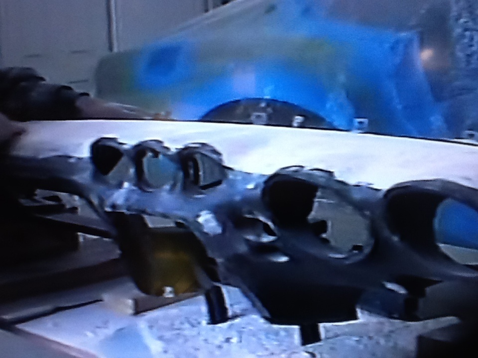

  21. So after dealing with all the rust ,it was time to get the body nice and straight with some body filler. I had decided to run the car without the rear bumper. So I welded a plate of steel over the concave section for the rear bar. I also cut the rear lower section with a slight curve up, like a rear defuser behind the petrol tank.

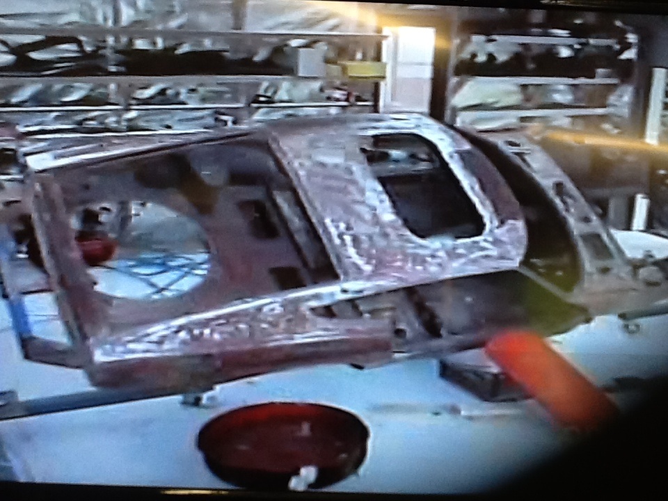

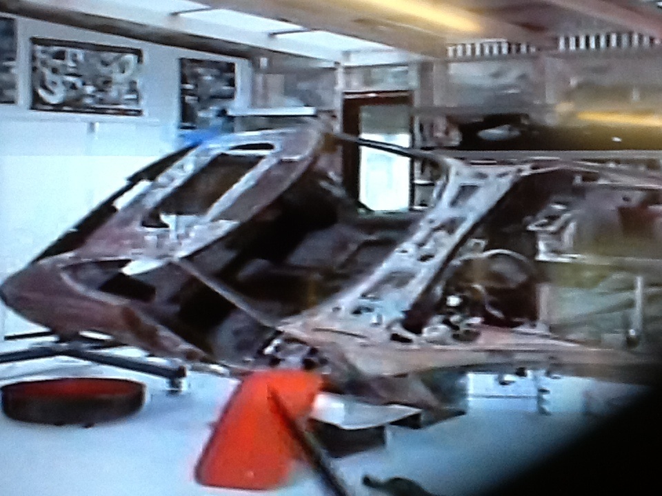

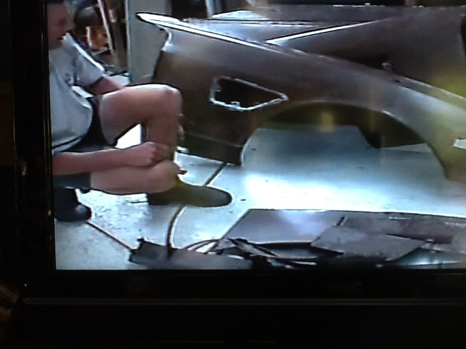

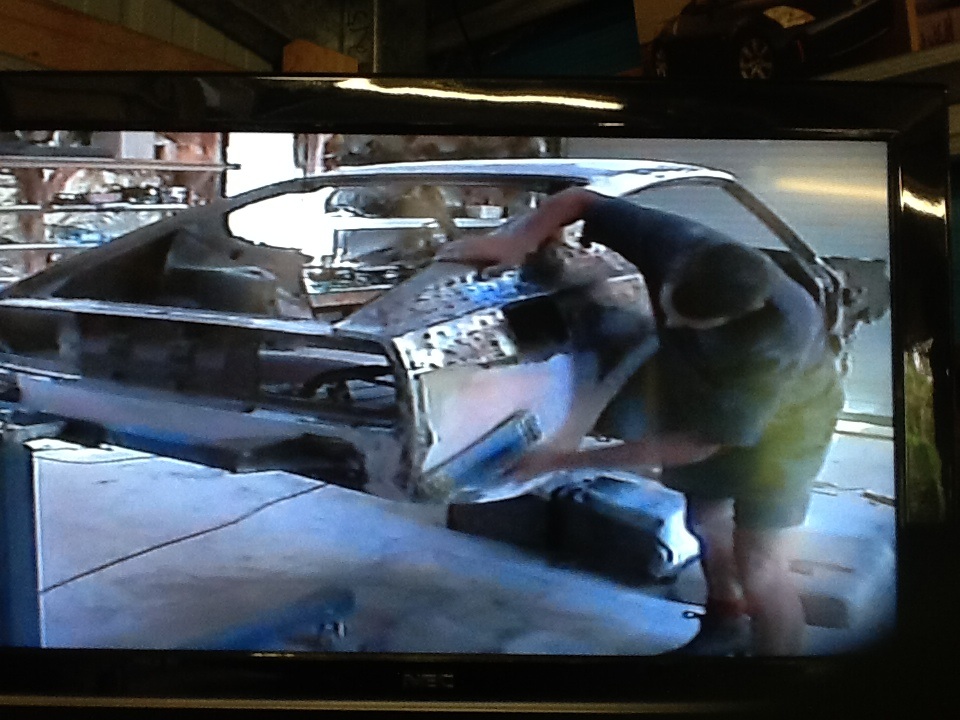

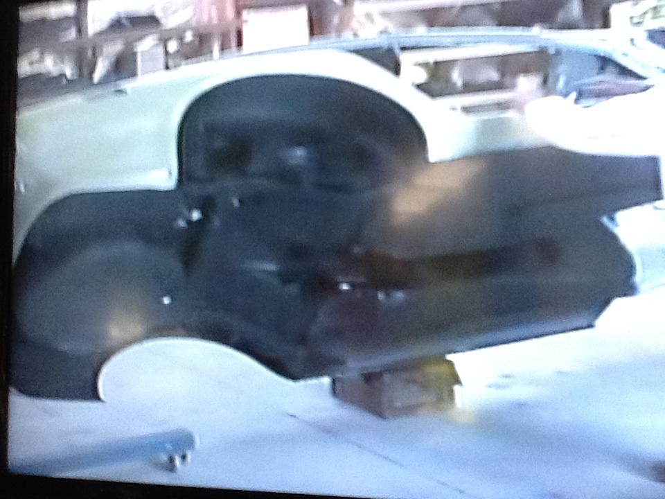

  22. Apologies for the pictures. I found an old tape that I made of this zed rebuild. It goes for about 4hrs. This is where I've found these pis from. But you get the idea. So it took awhile to get the shell rust free. But we got there.

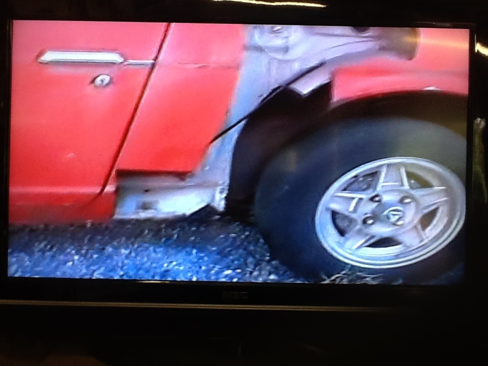

  23. The rear spare wheel carrier was next. This was taken from the donor car. As was the dog leg and front section of the passengers side. Even though its a 2+2 you can still use it.

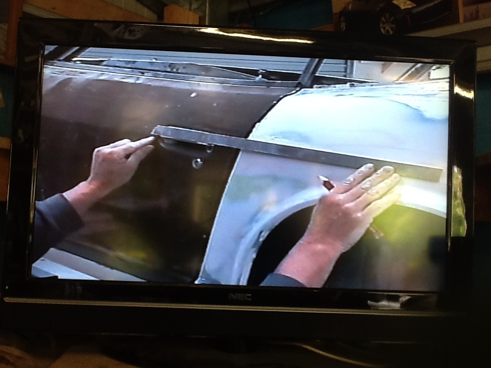

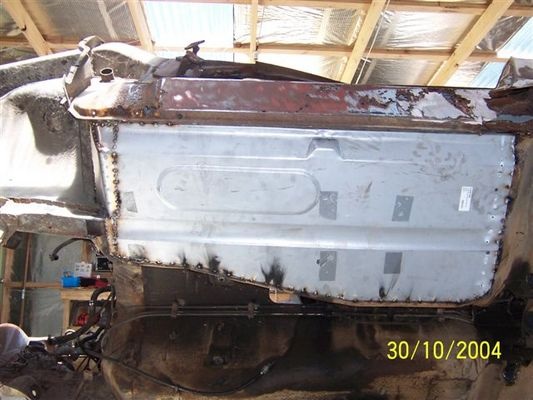

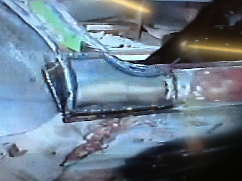

  24. After the sun roof it was time to replace the floor panels. Rare Spares had the replacement parts. From memory about $95 each floor. The chassis rail section is then welded over the concave section to form the rail. I also shaped and welded a 3mm thick plate of steel to the lower chassis rail at the front. That's where most of the jacking is done and I wanted to strengthen this part. This section of chassis would get crushed and creased.
