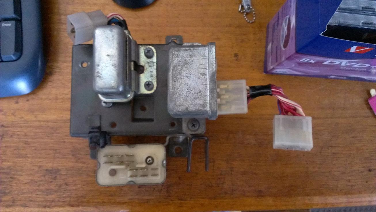

Retro Z Posted January 5, 2013 Posted January 5, 2013 Hi need some help. Wondering if anyone can post up pics of their passenger kick panel in particular the 'metal' Relays. Im wanting to know if there are any differences between 240z and 260z relay setups. I need it to complete my wiring on my 240z running a 260z loom with a l28et.. not sure if a usa 280z relay setup would work better as im going efi. Thanks Tai Quote

Moderators Zedman240® Posted January 5, 2013 Moderators Posted January 5, 2013 My 77 one looks like its the one you need; here's a pic Quote
Retro Z Posted January 5, 2013 Author Posted January 5, 2013 Dimitri are they 4 and 6 pin plugs? Quote

Moderators Zedman240® Posted January 5, 2013 Moderators Posted January 5, 2013 Yep, looks like it plugs into where someone wired up those two relays. Those other loose plugs that were nearby also look like they plug into other relays on the pic I added. Quote
