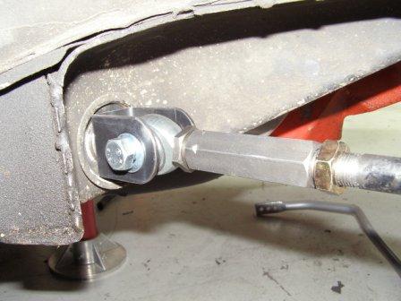

ZD44TT Posted July 24, 2007 Posted July 24, 2007 Hi guys, I got a wheel alignment and found my front right castor is off my a few degrees. Is it possible to shim it to point forward a tad to even it out? This imbalance is causing the car to slightly pull to the right when I brake. Thanks, William. Quote
620Z Posted July 24, 2007 Posted July 24, 2007 Put in adjustable control arms then you can move the whell forward slightly. The would fix your problem and is something I did to my car. It also helped with the handling by moving both forward some 15-20mm. I guess the cheaper option could be to get a bush or a couple of washer put in where the lower control arm is fixed to the bod of the car. I hope this is what you are talking about. Cheers Quote
ZD44TT Posted July 24, 2007 Author Posted July 24, 2007 do you know where i can buy adjustbale ones? and price? thanks mate. Quote
620Z Posted July 24, 2007 Posted July 24, 2007 Not sure where you get this stuff. Someone did it for me. Attached is what was done on my car. PM with an address if you want clearer or moctures. Quote
