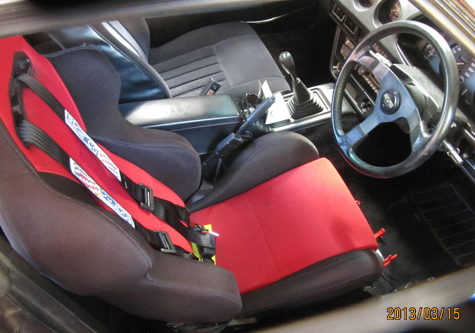

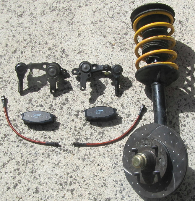

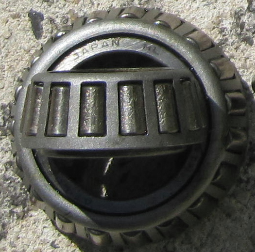

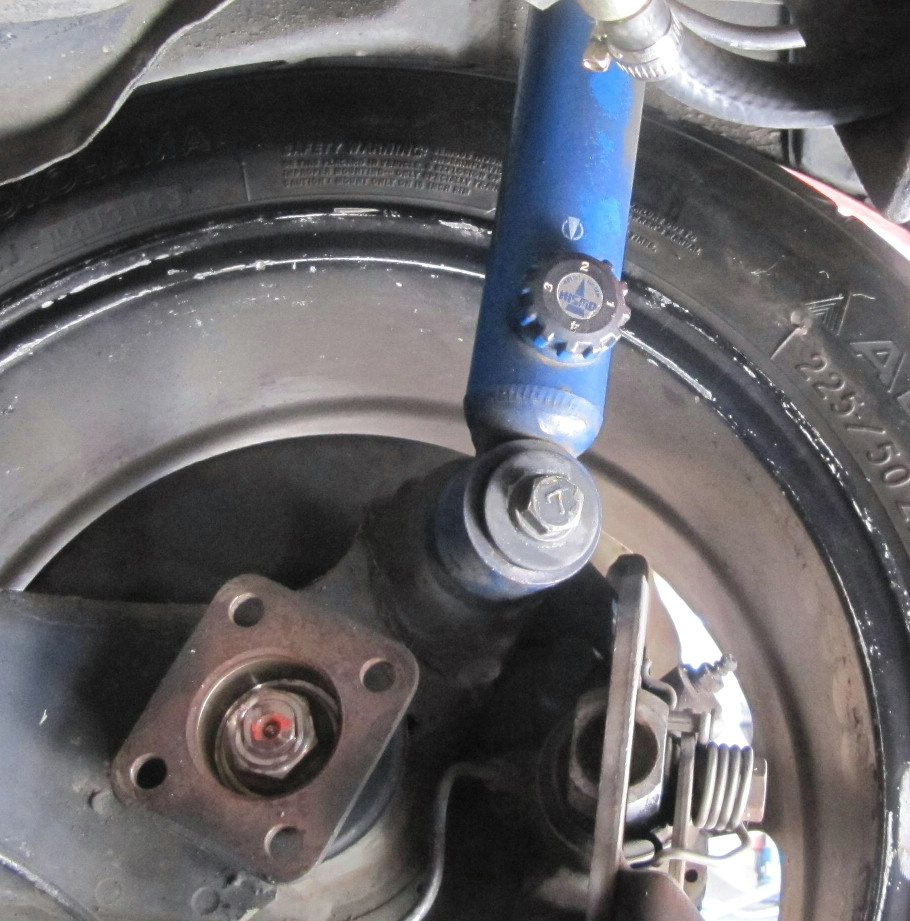

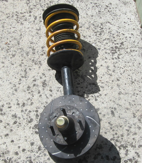

Whoray Posted March 25, 2013 Author Posted March 25, 2013 Getting car ready for Nationals has been a pain. Brakes at Calder Dec 2012 seemed to fade a little, so ordered Braided Hoses from ebay. Slotted and dimple drilled Rotors & TRW pads from Brake place. Hoses arrived from Canada only to find 4 hoses for front, none for rear, been chasing up now for a month, ready to ask for refund and buy elsewhere. Ordered rear hoses from Better Brakes ( who make on site) lunchtime 18th Mar, replacement arrived 2 hours later from Canada, rang & cancelled order. Removed hub to replace studs with slightly longer as not enough purchase on nuts. Also to fit new Rotors. Noticed 1 bearing was pitted, naturally replaced all front bearings. Fitted new rotors & TRW pads. While removing LCA & Caster Rod for Simon to extend for camber & caster adjustment, noticed the lower ball joint rubber non-existent. Luckily we had some new ones in Simon’s garage. His thread also shows the steering arm adjuster conversion. Car was far too high so have to lower with some springs from Iain. Driver’s seat padding was collapsed so new seat from Gumtree. Harness from ebay. So now have Better brakes, Lowered suspension, Adjustable Camber & Caster, Drivers Seat, Harness. Hopefully a Wheel alignment & Dyno Tune before Easter. Sun evening 24th Rough Camber & wheel alignment done and ready for road test prior to alignment at Trackside Tyres & Dyno with Lou & Richard. Guess what? New noise coming from drive line. Back into garage over night as getting late & Simon needs to go to work Mon. Monday morning, jack up & put on stands again. Start and put in gear, climb under to locate noise. Nothing from rear so move to middle under gearbox, yep gearbox making strange rattle. Remove tailshaft & run again, definitely gearbox. So time to pack up and share our 2 seater with Simon. Quote
