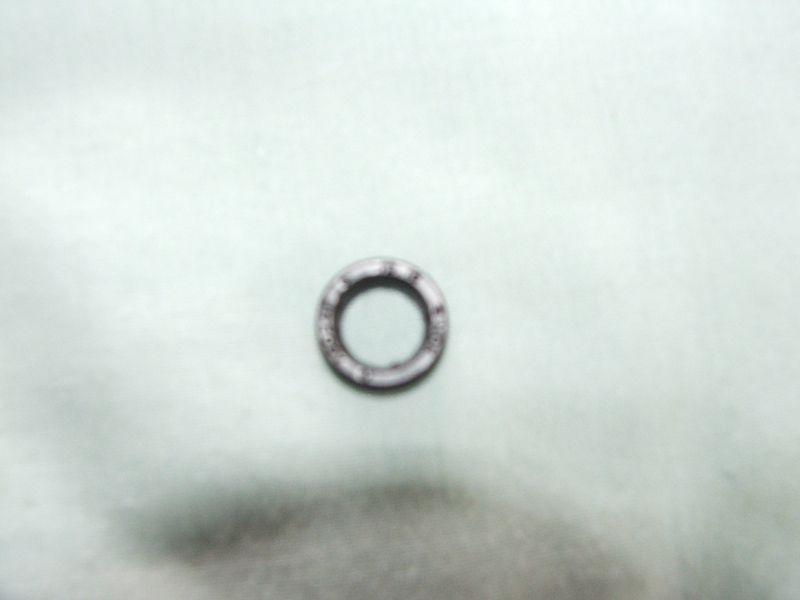

peter t Posted October 1, 2012 Author Posted October 1, 2012 Pulled the drive apart but there no O rings inside? Quote
Roberto Posted October 1, 2012 Posted October 1, 2012 The o rings look like this: Apparently, there is a small o ring and a large o ring in the part that mounts in the transmission. The inner small o ring stops fluid from going in the cable and large one seals in the gearbox. I have done some research as I need to do mine. Yes, you may find something suitable from other industrial suppliers. Nissan may have them too. Quote
peter t Posted October 1, 2012 Author Posted October 1, 2012 Got the sucker out. It is actually a small oil seal. Will try to source locally and will get you one also. Numbers on seal are NOK AGO 24IF 12. 18 It is the one on the left of the red dat pics. The O ring in the pic is the outside ring. Quote
