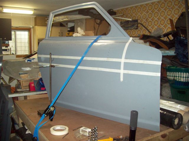

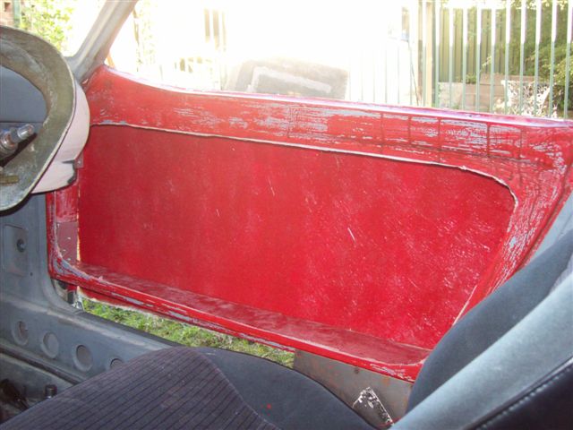

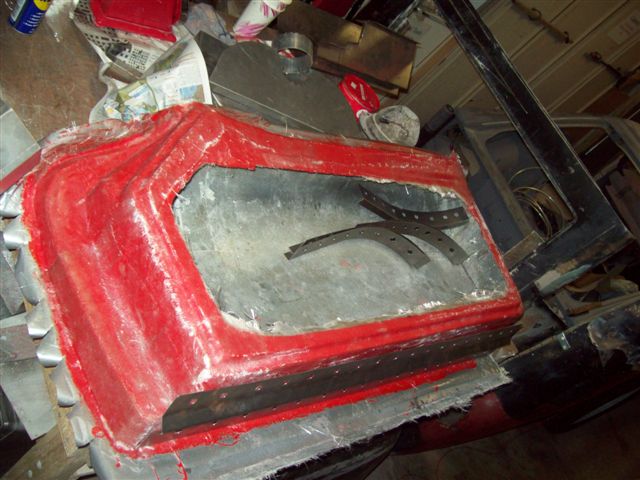

When I did it I just basically made two moulds, one for the skin and one for the rest. While my doors are considerably modified and I started from fibreglass doors it shouldn't be any problem with original doors. There are enough contours in the shape to create a stable mould but I did insert a rib along the base (see photo)

To be honest there would not be much weight saving in doing that. While the fibreglass door is lighter to achieve that you have to keep the material fairly thin and it would probably lack the durability for road use. The HUGE weight saving is in doing away with the window glass and the winding mechanism.

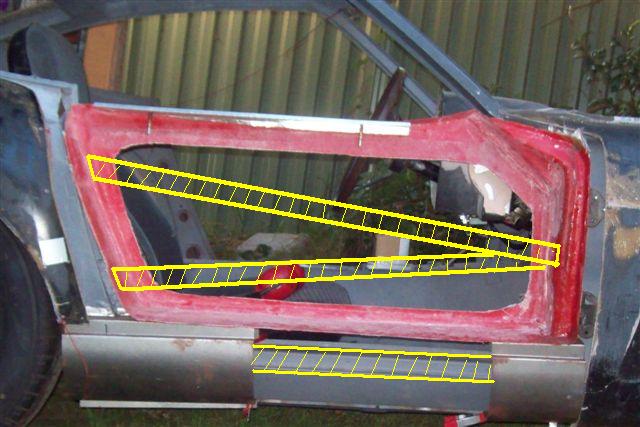

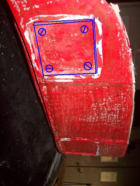

I have incorporated recesses to fit end-plates to the intrusion bars which ensure the bars do not simply move into the cabin but have to overcome interference from the welded seam around the door opening. In addition by shortening the height of the door (50mm top and bottom) I now have larger sills through which I can install added intrusion bar - chassis stiffeners.
