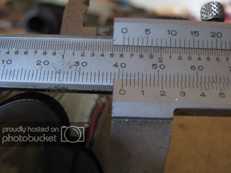

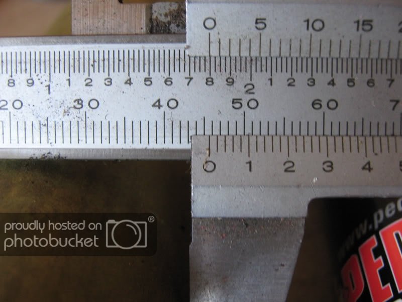

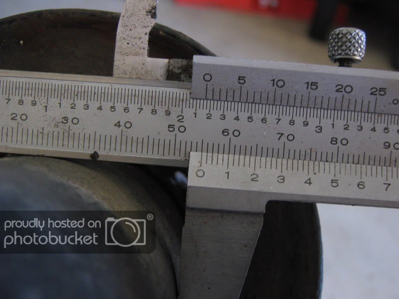

juz0 Posted May 3, 2012 Posted May 3, 2012 Hello everyone! I'm in need of some help with shocks for my front end. I bought some el cheapo pedders shocks to put in the front and rear while im getting it on the road but they are physically smaller in diameter than what was in there It has Bilsteins in the car originally, but the part numbers dont match up to their catalogue (according to the rep i was talking to). The OD on the front Bilsteins appears to me an imperial size but could be paint oversizing it. So i'm a bit lost as to where its gone wrong / mismatched The front tubes are 55mm OD Bilstein shocks are 45-46mm OD Pedders shocks (front and rear) are 41mm OD i dont have any inside mic's or telescopic guages at the moment to measure inside the tube. I've been searching around for what size OD shocks are going into the tubes but i haven't found a hell of a lot. so can anyone help out with some info on shock tube sizes and shock OD sizes. also the part number on the bilsteins are P36-065 the bilsteins have hot spots around the chrome thats why i'm replacing them. which is a shame because the rods are huge compared to the pedders shocks thanks people Justin Quote
