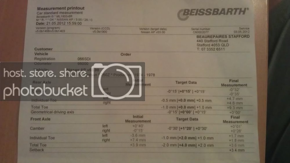

Jz260 Posted June 3, 2012 Author Posted June 3, 2012 Hey again all, Most recent news on my car; I got a wheel alignment done the other day. Took it for a drive after and it felt like the turn in was a fair bit better as well as the steering was more precise. Here is the data they printed for me. I'm not sure at this stage what I want to do next. The to do list is; LSD Roll cage Suspension Brakes Quote
