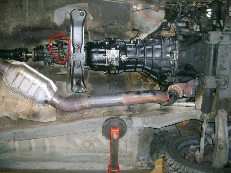

nizm0zed Posted March 14, 2012 Posted March 14, 2012 the electronic speedo transducer from a later model box will screw into the L series box. You can get it from any skyline (R32-R34) Silvia/180sx, some Bluebird ect ect. I have one in the shed that it'll be using from a CA18 Manual S13 Silvia. Quote

saxon Posted March 14, 2012 Author Posted March 14, 2012 Thanks mate, awesome tip! It's the speedhut revolution, black, the light blue back lighting, red needle, indicator and high beam lights. I'll give the electronic speedo transducer thing a go first though. Can you please take a picture of yours for me so I know what I'm looking for? Quote
nizm0zed Posted March 14, 2012 Posted March 14, 2012 thats pretty much as close is i can find after a bit of a google while at work. That is on a R31 Skyline (Import Coupe, the oz ones are mech.) The electronic sender unit part screws on where the cable would go, So your basic calibration can still be done by changing the cogs. in reality, thats not needed though, all you need to know is the amount of pulses per revolution and you can calibrate your speedo to suit what it puts out. Yep, definately interested if you do want to sell that gauge. Quote
