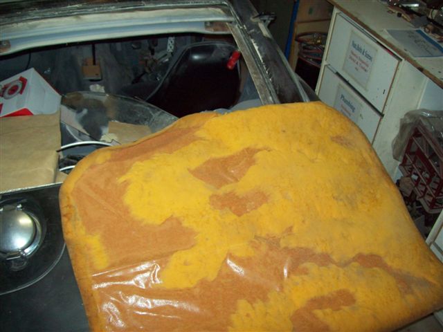

PeterAllen Posted February 25, 2012 Posted February 25, 2012 ...Perhaps my "roof" is a bit thicker than normal ... Tim (aka HYQ) - There is something 'a bit thicker' about all this but it's not your roof! Here is my roof liner and while it's a bit moth-eaten there doesn't appear to be any pattern suggesting vibration dampening webbing or the like. It's a bit sad that you are already looking for excuses and you haven't even competed. Do I detect some Pommie ancestry! Quote
RB30X Posted February 25, 2012 Author Posted February 25, 2012 Does that glue straight up to the steel of your roof though Peter? I'b got meeself a new ruddy clutch now so i gotta fine meeself anova excuse doun I ....... Quote
