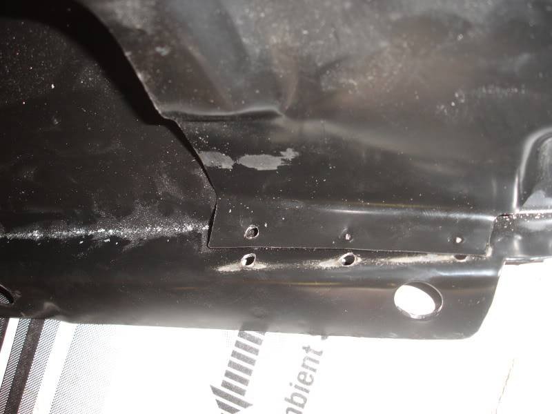

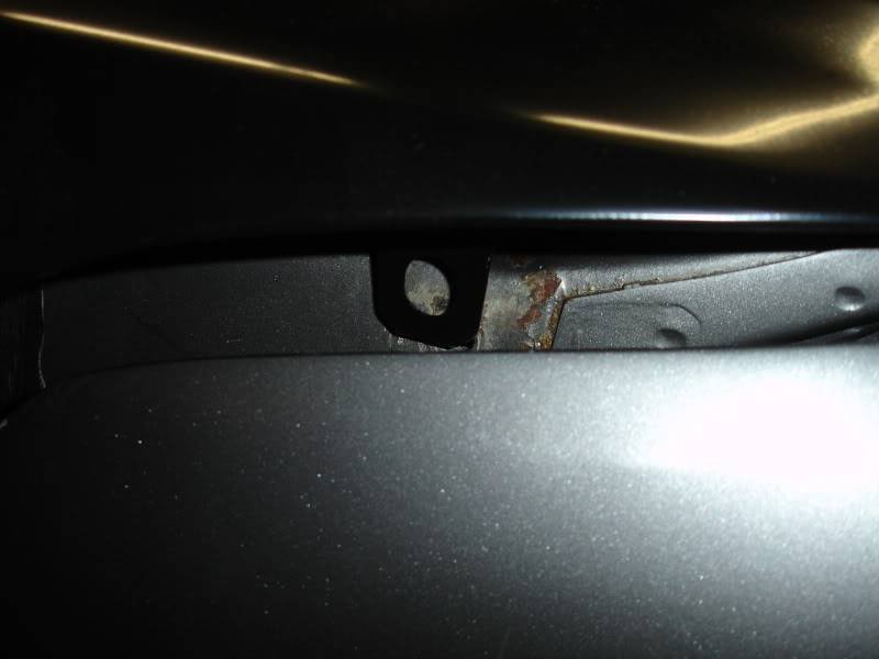

There were two major issues with the door gaps.  Firstly, it was obvious that there was a section of the outer skin that had not been folded around the inner pressing and this fouled the scuttle under the windscreen.  There was a section of about 100mm that simply had not been folded and it was the same for both LH and RH guards.  Checking my old guards confirmed this and a few minutes with a body hammer sorted this.
Secondly there was trouble with the inner skin fouling the seam at the top of the inner guard and no matter what I tried the gap at the top of the door was too big.  Again checking my old guards showed the inner pressing was welded badly and needed to be changed.  Drilling the spot welds out and repositioning the inner skin made enough clearance to get the guard sitting down low enough to make the top of the door gap OK.

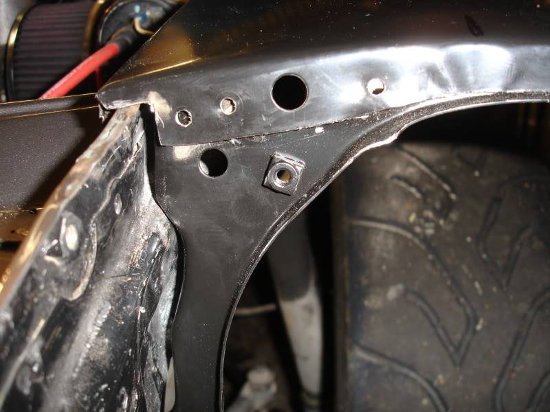

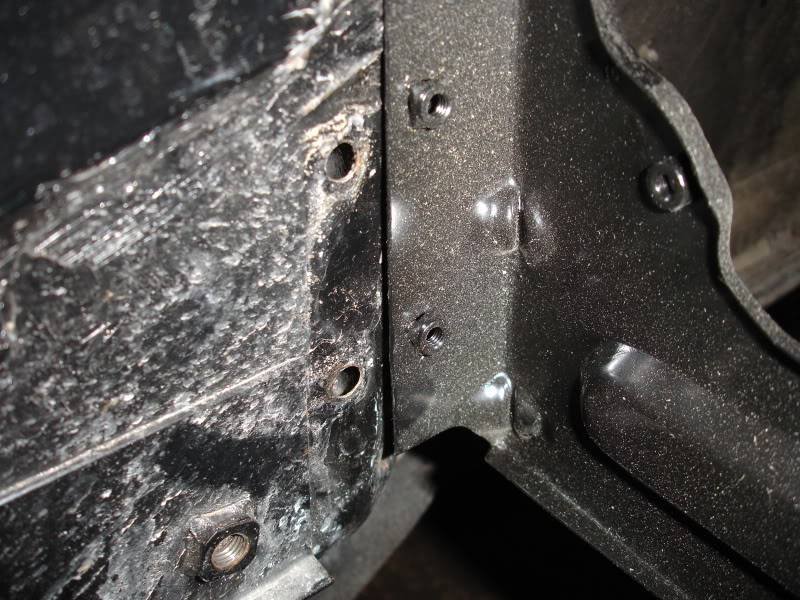

I then needed to make some changes at the headlight mounts.  Again it looked like the headlight pressing had been welded too close to the outer skin making it difficult to bolt up the guard and very hard to make the scoops sit flush, this also effected the fit at the bottom of the door as the whole guard had to be twisted to get the holes aligned.
The fix again was to drill out the spot welds and then offer up the guard, fit some bolts and then tack and weld the sections back with the right alignment.

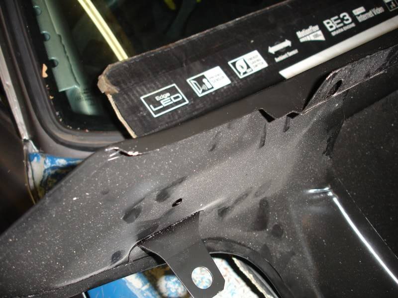

With a bit of trial and error it was possible to get some reasonable gaps all round.  The one last issue is with the section where the bonnet and the inspection covers meet at the corner of the guard, again the outer skin is badly folded leaving a sharp edge and a small gap that you can't fill.
The one part I couldn't fix however was the section that curls around the bottom of the screen.
On the RH guard (the LH one was fine) the curved section at the base of the screen had the wrong profile and didn't match the curve of the body.  The door is made up of four main parts, the main outer skin, the headlight mount and two sections that make up the brace at the rear of the guard.  Each of the separate pressings look accurately made but the manner of assembly leaves a little to be desired and in this particular case the folding of the outer skin around the inner skin at base of the screen was done badly and meant the alignment was out and it was beyond my skills to rectify.
I was able to tweak to the section to fit around the screen and make it look OK but it certainly isn't a great fit and where the guard should come to a point it now comes to a flat end which isn't a great look.  Lastly, I had to slot the mount holes where it meets the inner guard along the bonnet line. For me it will be OK as it's a rally car but for a road car it probably wouldn't be acceptable and would need some expert hands.
