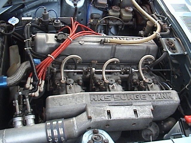

You can get carbs modified to suit turbo and most carby/engine shops should be able to do it for you. If you are serious about the turbo carby L28 google "hks surge tank"... or see the photo below:
and this one (big photo) http://i28.tinypic.com/2ntuxvr.jpg
There are other companies that made intakes/full turbo kits in single and twin turbo form to suit carby L series cars but my knowledge is pretty limited with that sort of stuff.
