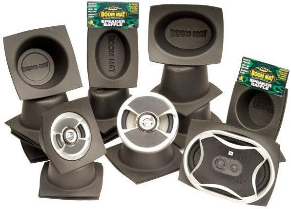

Six_Shooter Posted December 1, 2011 Posted December 1, 2011 I'm not sure if you can get them over there but here, we have speaker pods (for lack of a better name) made of foam that enclose the rear of small speakers. This helps with a more controlled speaker (improving sound), but I wouldn't expect any miracles. The biggest thing to try and do and isolate the rear wave of the speaker from the front wave, in other words, isolate the sound coming off the rear of the speaker from the sound coming off the front of the speaker, as much as possible. The other thing that will help, and a lot I might add, is solidly mounting the speakers. Building a bracket that attaches to the structure of the car to support the speaker will help improve sound, along with reducing rattles and buzzing from interior panels. Quote

Six_Shooter Posted December 2, 2011 Posted December 2, 2011 Here is a picture of the foam based speaker enclosing pieces (I resist calling them baffles, because a baffle refers to a different part of a speaker mount). Quote
zeds4ever Posted December 5, 2011 Author Posted December 5, 2011 Thanks for the info mate, will try & source them over here. They look heaps better than foam rubber. Regards: Alan. Quote
Scoota G Posted December 6, 2011 Posted December 6, 2011 One place you'll find them is on ebay international. They look pretty groovy hey! Quote
